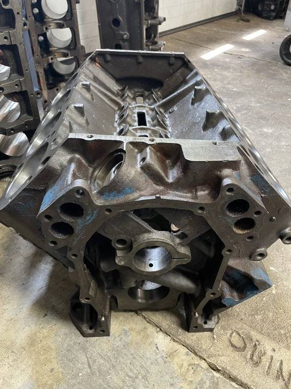

Engine block and components update:
The parts were successful separate and the 413 has been bored .030 over. The rest of the block looks good and this is not the final hot tanking or cleaning.

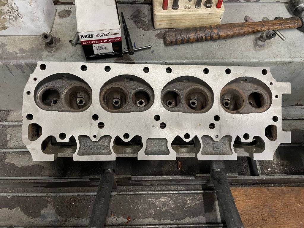

The heads are cleaned up and will have hardened seats installed.

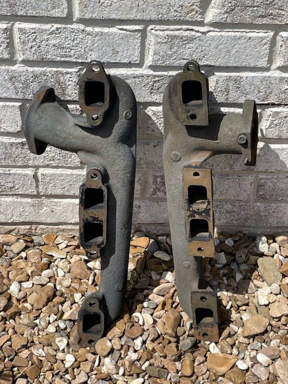

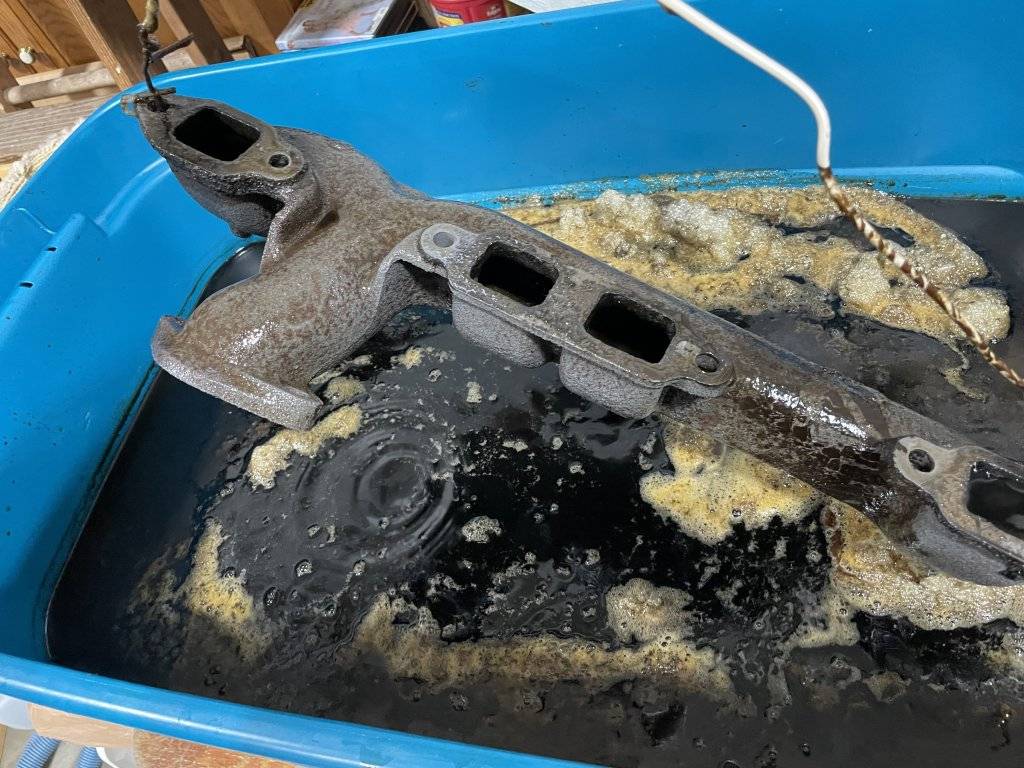

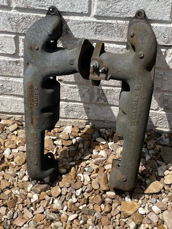

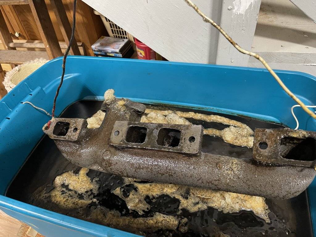

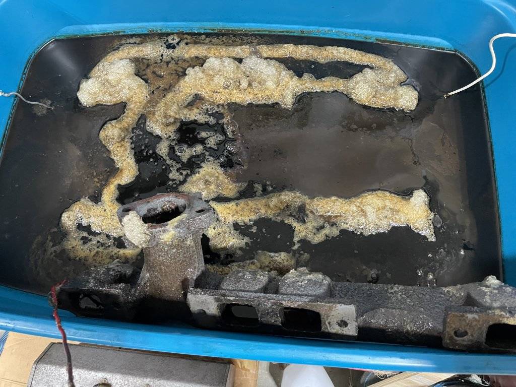

The exhaust manifolds were soaked in a 9 to 1 solution of water and molasses for approximately a month now. As an experiment and because of a lack of a blasting cabinet. Here are the before pictures.
And after two weeks coming out of the tank for a power wash.
Finished pictures next post.
Another two weeks and after just power washing.

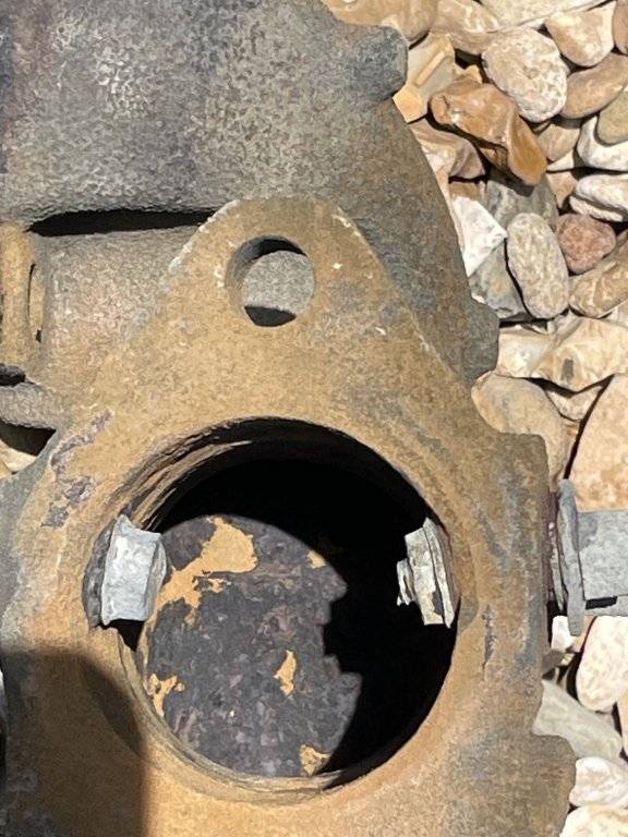

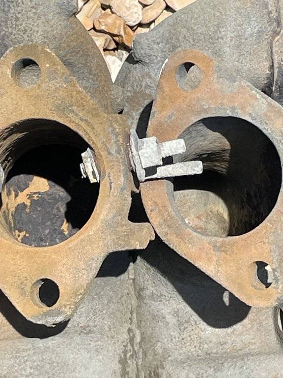

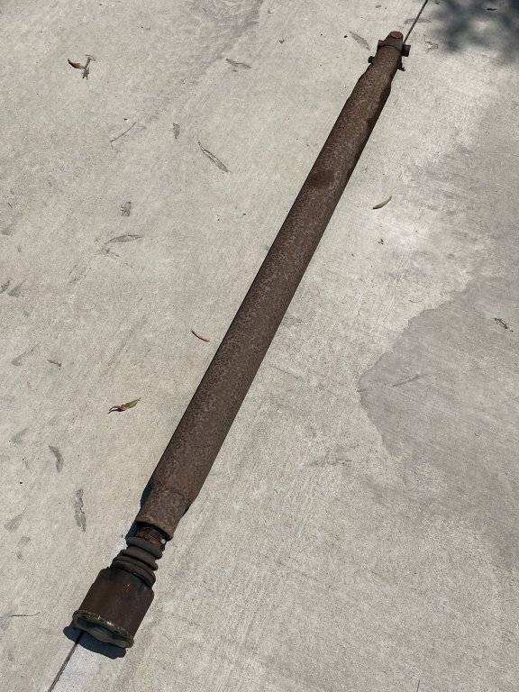

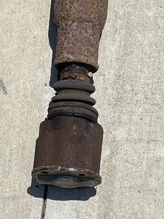

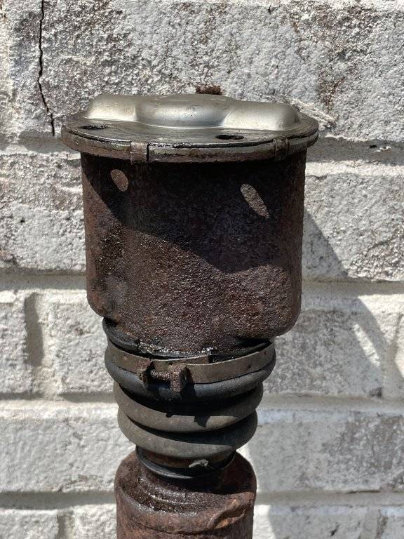

Now the driveshaft was also just power washed at this time and here is the shape it is in.
A shop looked this over for me and it was an old school kind where the guy knew what it was. He grabbed it from me as I walked in the door and set it on the counter. He started wiggling, pulling and feeling the front joint. He proclaimed that it is surprising in good shape. He talked about not being able to get the required parts to fix them anymore but there were “expensive” replacements parts now. But he saw no need. The back u-joint would need to be changed.
Now the rust on the tub is an issue but kind of depends. He says that if you don’t beat it to death it should hold up. I asked about painting it and his reply was don’t be aggressive at all in sanding it. A scotch pad maybe but very light. So right now it in a pvc 4” tube with the molasses mix to dissolve the rust. We’ll see. The front joint is not soaking.

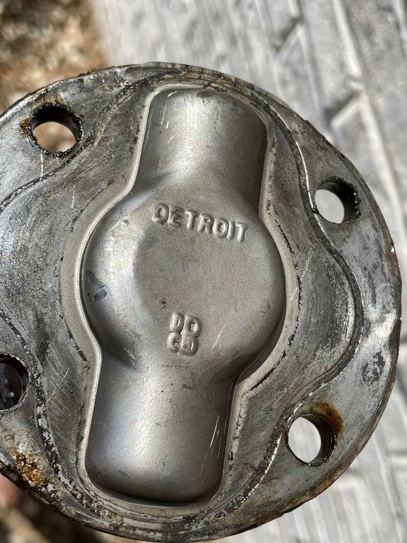

I am wondering about the top cap on that joint. Can that be removed to add grease in that cavity? I haven’t read the FSM yet. Just thinking of the top of my head.

That’s it for now, other than I’m going to clean the exhaust manifolds a little more and apply Fluid Film to them and maybe use that on the driveshaft too.

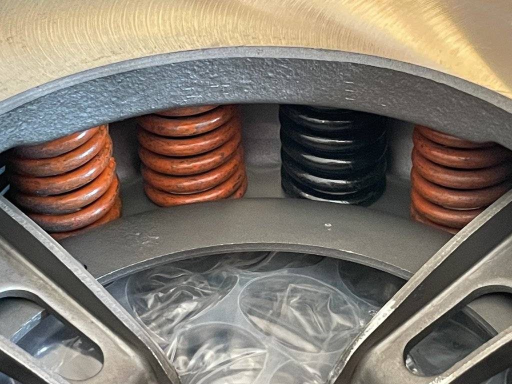

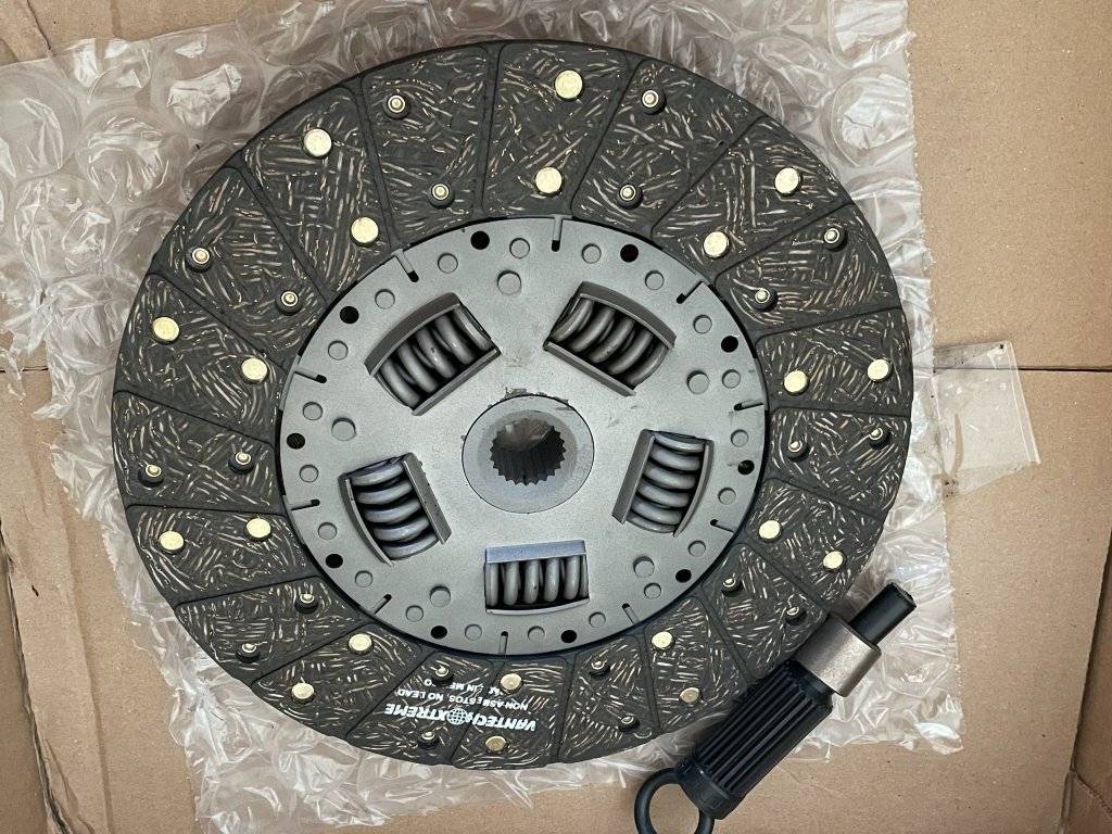

In the meantime, I decided to have the stock Borg and Beck clutch rebuilt by Kentucky Clutch. I sent this plate and disk to them last Friday.
On Monday I received a call from them letting me know it arrived and asked what level of performance I was looking for. I told them stock.
I was told it would be finished later that day so payment was complete. It was $165 plus $35 for UPS shipping.
Today, Wednesday, my clutch arrived back and man I was surprised. Nicely surprised!
It was a Super job, with a friction plate lining from Mexico, a new looking pressure plate, a new throw out bearing, a thrust bearing and an alignment tool. I didn’t even know all that came together.
It cost $35 to send it to them but I think it was worth it because these B&B clutch packages are unavailable now.

On your mention that hte B&B clutches are non-avail, I went scouting to get a spare for my 65 SF (believe I put a diaphragm style in there years ago).
Found a bunch of ~ $400 hi-perf clutches on Summit, Jegs, etc.
Found a $125 stock replacement on Rock Auto, so I jumped on it.
It arrived with a made-in-china sticker on it.
How/why did China repro a B&B clutch???
