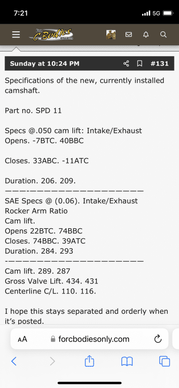

I didn’t get the cam specs until it was already installed. Here are those #s
Wow I am getting a lesson on camshafts and what the numbers mean. That’s all good because I like to understand this science.
With the advertised duration being 284 & 293 I was concerned that was too aggressive. The more accurate measurement is from 0.50 so those are 206 & 209. So this Melling camshaft is staying put.

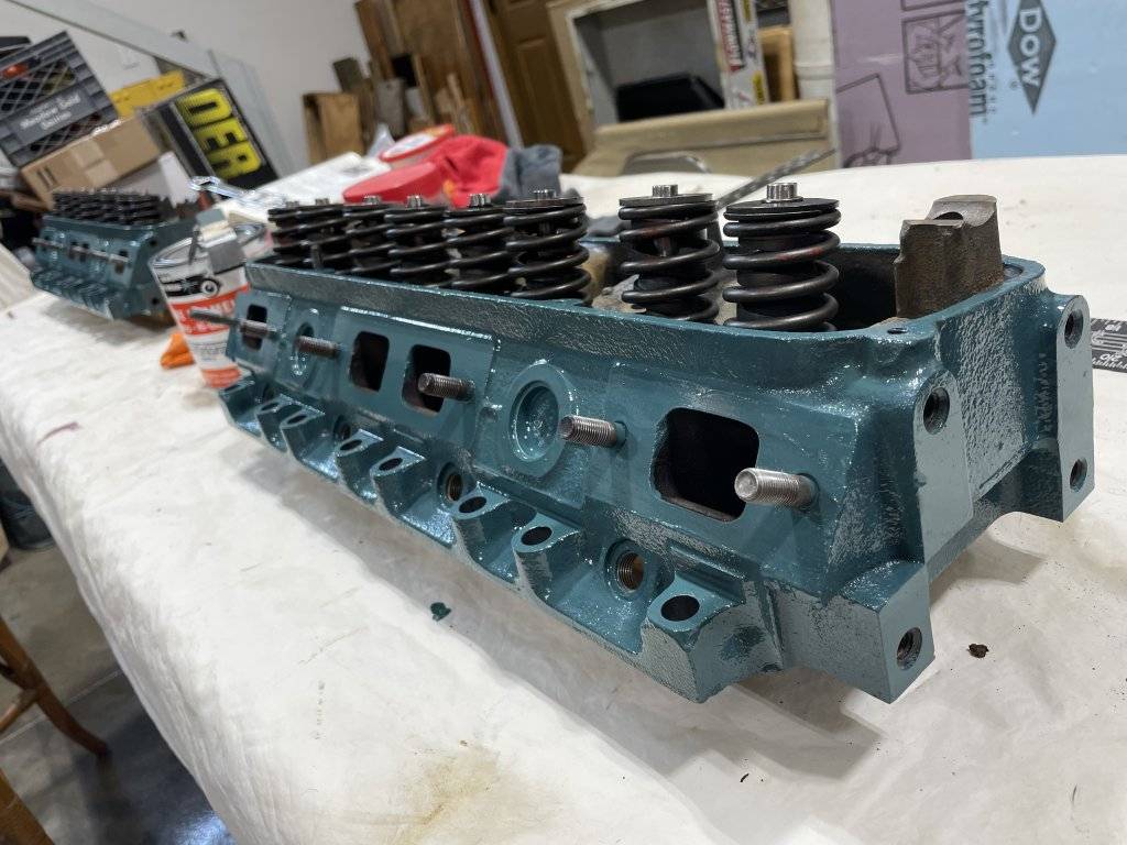

The heads is something else I’ve been looking at. The exhaust hardened seats were installed. While watching an Uncle Tony’s Mopar video he was using a straight edge to see how the top of the valves (8) lined up. He said to match longer/shorter push rods with the longer/shorter valves. When I did that to my 2 heads what I found was the (4) intake valves sat .017-.20 above the exhaust valves on one head. The other head was the same as far as the intakes being taller but its difference was .025-.037. Do you think the hydraulic lifters will adjust correctly to the unequal valve stems?
Putting shims under the valves won’t correct it.

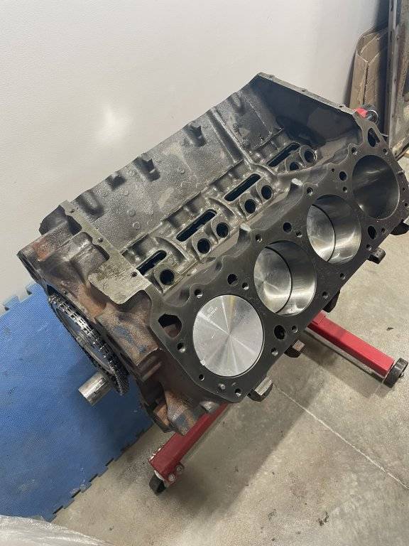

Here is the over bored 413 back in my garage.

How far down is that #1 piston from the deck surface?
Picture might be deceiving, but looks closer than I expected.
I measured it at .050 with a feeler gauge.
So a few posts back I mentioned that the pistons that were removed from the 413 had a compression height of 2.022 and the new ones were advertised as 2.015 but that that measurement was not checked before installation. I think you said the stock pistons were supposed to be 2.085.
The heads were painted with the Bill Hirsch Turquoise paint.
I think the 2.085 was my guess based on factory 440 pistons and then extrapolating that to the 413 due to same stroke/deck height.
But I now realize that is an error, as I was assuming a common 10:1 CR between both engines, and I overlooked that bore size can't be ignored as part of that CR assumption.
To change the bore size but keep the same CR the compression height of the piston must change.
Interesting on the .050" with those pistons. that would be perfect for quench with those -516 heads - if you didn't need to put a gasket in.
The Mr Gasket steel gasket is advertised as .020" compressed IIRC, which makes .070 between piston and head. Good for CR, but might cause it to be a little octane-sensitive?
Some folks have said you can run high CR with tight quench (.04-.05) but running the reduced CR and less quench that comes with pistons further in the hole can be a problem.
Do you know if they decked the block? (I apologize if you've already said so)
This makes me wonder if those pistons might make it possible to build a decent-CR 413 with quench. (That would be somewhat a miracle these days, and would require very particular parts)

I was told that a minimum was removed from the block deck and the heads, only enough to make them straight.
The head gasket that came with the rebuild kit has a .040 head gasket, I did measure it. The Summit .030 thick head gaskets that are $37 each, so $74 a set. At this point I was thinking a little less compression is good for the poor gas out there but where I’m at now has many non-ethanol gas choices close by. That’s a wonderful situation.
