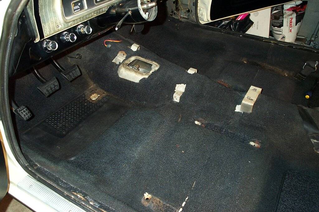

Actually I believe they used a one piece carpet in front with cutouts for the shifter & console brackets. This is based on a few C-bodies I've seen which are similar to the '65 Satellite of mine shown with original carpet. The aftermarket carpets all come without cutouts which you'll have to make (carefullly!) and lots of excess material which will also need to be trimmed.

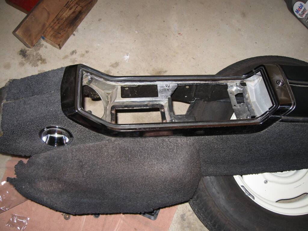

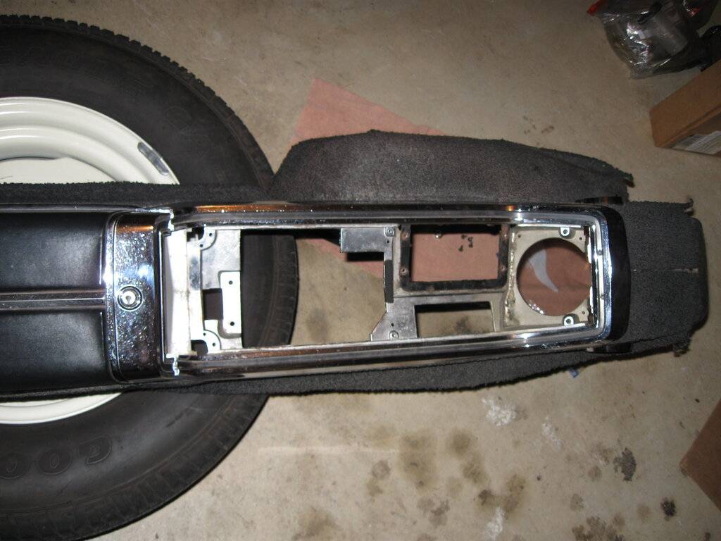

Sorry, misunderstood question. The console carpet at the front is 2 pieces, it's glued on.
