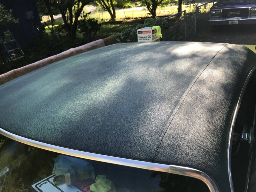

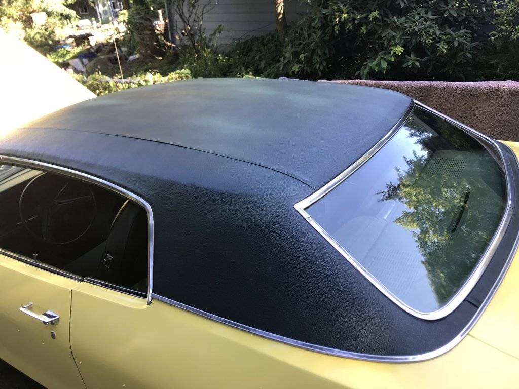

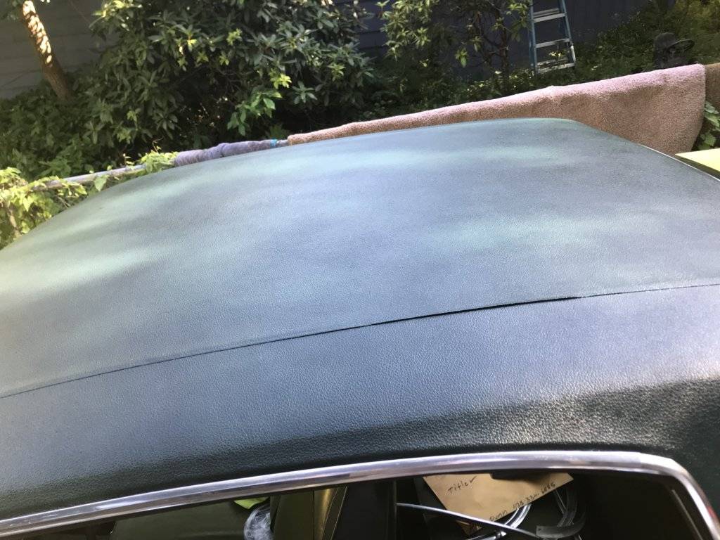

Wow the vinyl top came out beautiful. Lovin the green top. As I was told on this thread, I washed it twice with soapy warm water and a soft bristle brush. Then I cleaned it twice with Lexol Leather/ Vinyl cleaner. Lastly 2 coats of Meguiars vinyl protectant. It really soaked up the first coat, I’m sure it’ll soak up the second as well, so I’ll just continue applying it until it stops soaking it up and maintains its shine. I put the car on ramps to do another oil change, adjust the torsion bars (only slightly, maybe 1 to 1 1/5 full turns. I have experience with torsion bars on later model Chev pickups and SUV’s. I’m really excited to get the exhaust done. Right now the leak is hideous and sounds awful, down on power.
Lastly, when I went around a right hand medium speed turn last night I got an awful running type noise like a big chain was hitting the wheel. Once I straightened out it went right away. Anybody familiar with this? I thought perhaps it was Wheel or tire rub, but it looks as if the sway bar and torsion bracket might have been pulled on forward. I’ll look at it, but I was curious if anybody was knew exactly what it was or if it was a common issue.
More pics later!!! Here’s the top
View attachment 200147 View attachment 200148 View attachment 200149
Be careful that Meguiars vinyl protectant is water based and may streak when it rains. It's very hard to find anything for vinyl tops. I have a can of vinyl top wax that is probably almost 40 years old. Once I run out, i'm screwed!
Top looks great Chad. Glad to see you got her back up and running. Great Job!!!!
Keep us posted on the rest of your progress as you sort her out.
Will do. I won’t be in rain much but I’ll try and find some old school petroleum based top stuff.
Let me know if you find anything, I have been looking for quite some time.

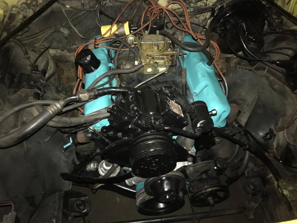

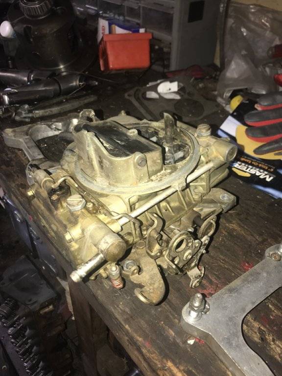

Will do! Do you guys know much about my 4 bbl Edelbrock performer intake manifold and 4 bbl carb swap? My question is this. I have a Holley 650 with what looks to be a vacuum secondary, and I also have two thermoquads, one which is in good shape and another that’s complete but needs rebuilt or to be used for parts. I can either use the Holley or use the thermoquad and have plenty of parts if needed. On a 360 2v with 9.1:1 compression and stock cam I’m not sure which way to go. I know I can dial the fuel back, and I always hear Steve Dulcich praising the thermoquad religiously on Roadkill and RK Garage. I have no experience with either.
Also, I need a tech tip. I’ve noticed that after about 20 mins of driving, if I have the car idling in Drive against the converter the oil light begins to flicker. In N it’s gone. But the longer I drive the worse it seems to get. It gets to the point where I need to have the car at 11-1200 rpm to get the light out. The motor doesn’t knock or anything, but it’s definitely losing pressure the longer I drive. No lifter noise either. My thought was the screen is getting blocked and when I shut car off for a while whatever debris drifts away from the screen. I just don’t know what could possibly have gotten into the case/ pan since the motors never been open, except maybe a couple teeth from timing sprocket. Yesterday I changed the oil/ filter and same thing. Any ideas? Should I pull pan? Maybe sending unit? I don’t know the threshold for the dummy light in this thing...
And a few mins later...
so... Holley or thermoquad?
And increasing low oil pressure the longer I drive.
Thanks guys I appreciate it
I would put some STP oil treatment for the zinc regardless of the light. Helps with scuffing of the bearings and cylinders/pistons.
Then put an oil pressure meter into the sensor hole and see what you have at idle.
If less than 10 psi at idle, you have a problem with either the pump or just worn out engine. But I doubt it.
Can you see oil movement on the rockers through the filler hole? My money is on the sensor.

Your thinking the problem too hard regarding the oil light.
From your video we can see the temp is low so the oil should be good and thick. As the engine warms the oil also heats up and becomes much less viscous (thinner) so the oil pressure naturally drops. The sensor is there and set to a low pressure point where it makes ground and the light goes on. (Like when you first start the car, you should see the oil light on bright and go out quickly after the engine fires)
The sensors do fail and can misread the pressure; sending a false ground to the light. This can also be caused by debris or just plain old sludge where the sensor goes in. (Seen that several times)
Start with the sensor. It’s cheap and will tell you quickly if you have a problem. Make sure the passage the sensor goes into is not all fouled up before you put the new sensor in.
Let us know how it goes....
As to Thermoquad or Holley, I’m a Thermoquad guy.... they can be a bit fussy but tend to run a bit more economically than the Holley and produce the same result: air mixed with gasoline. But make sure it’s the small bore 1-3/4 secondaries version. Primaries are the same in both versions.
Even on the 360 the smaller bore version is more than enough. The 2” is way too much carb for that engine IMO without heavy breathing modifications to it. Just look up Thermoquad on google for the lists of carb numbers to see which one is correct for your year and engine size. This makes a big difference on tunability and performance.
Oh... and they sound great when the secondaries kick in.
Holley are good as are edelbrocks too. All should fit your manifold I believe. Ultimately, go with your gut.

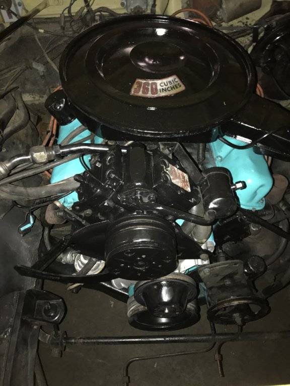

Lastly if you have a look at the engine bay you can see what I mean on the importance of cleaning and painting that monster A/C pump. Looks so much better, even though I cleaned up bay a lot, as well.

I did rebuild the 4 barrel Holley yesterday. I used a universal kit, tore the carb down to nothing, cleaned it up, and replaced every seal, gasket, and spring. The old gaskets were a total PITA to get off, and the whole process took Maybe 5-6 hours, but I’ll be comfortable knowing it’s done and any issues will be unrelatable to the carb.
