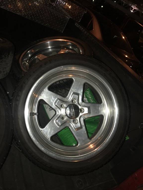

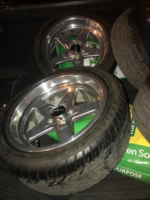

17x8 5x4.5 w/ 4.5 inch backspacing and a 0 offset front 225/45/17 95% tread
18x8 5x4.5 w 4.5 inch backspacing et 0 rear 255/40/18 95% tread
American Racing AR135 Torqlite forged
I got the best deal ever, just had to drive deep out to the Peninsula to get them. Install tomorrow after exhaust is done!
Very excited.

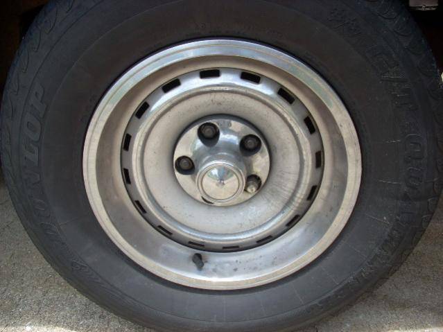

I 1000% understand the purist route. My big thing was one of the white wall tires with the Chevrolet wire caps was separated, and the caps were Chevrolet.
I was looking for a replacement wheel or
cap that would fit the c body better, have good rubber, not be Chevrolet, and fill out the wheel wells better. To find those wheels and tires for $500 I think is a steal. They are the exact right fitment and even came with the appropriate lug nuts. They have new tires, are balanced, and I can literally bolt them right up. Not the look I would be after ideally as well, but within the budget and will straighten up the few issues I just mentioned. They are better suited for an A,B, or E body car, but at $500 for a complete set I am happy to have them.

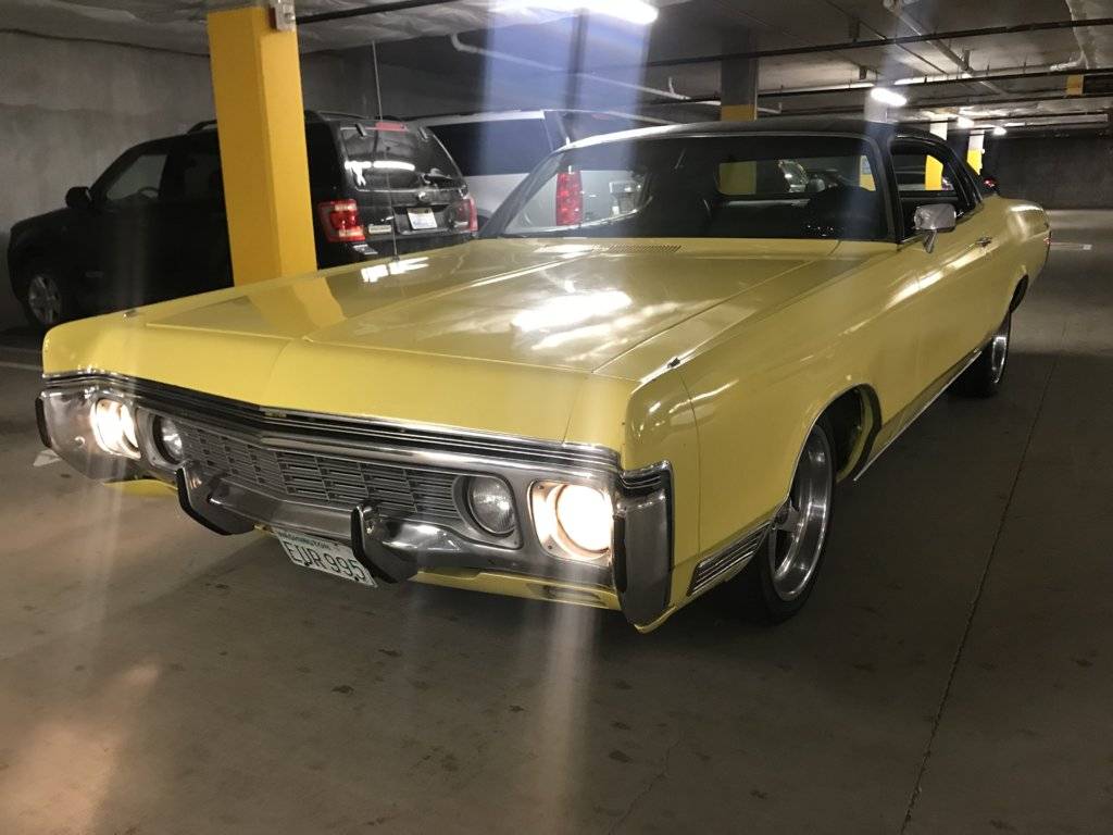

Big update. Car now has true dual 2 1/4 and some 2 1/2 true dual exhaust. No h or x pipe (true dual) with a pair of turbo glass pack mufflers I bought used from the exhaust shop who did the work. I just had the regular pipe pointed down at a 30 degree angle at back. On my 81 Chev lowrider pickup I had the same type of exit and really liked it. The driveway sweepers. Also for the C body I wanted to keep it classy and basically run the factory routing just mirrored on the opposite side, no big chrome tips or anything crazy. You could call this a “purist” type Choice. I like the way the car sounds. Still has the nasty leak at the manifold. While on the rack I looked and the very back bottom corner of the manifold is not even there. Easy fix though, even if I break a bolt I have everything I need to back bolts out and replace them. Also I am going to remove (prob need to cut) the downpipe flange bolts out and replace them with new donuts and bolts.
The car has definitely regained some power with several less exhaust leaks now and the better flow. I can imagine it’ll be right on point once I seal up the last big leak....
As well as install this.....
Friday I bought the Holley 4160 rebuild kit and tore the carburetor down to the core. I rebuilt it completely except for the electrical choke. I cleaned the mani up best I could, rebuilt the carb, and it’ll be ready to go on Monday.
I’ll do exhaust mani and downpipe gaskets at the same time. Afterward the car should really be where I hoped it would when I purchased.

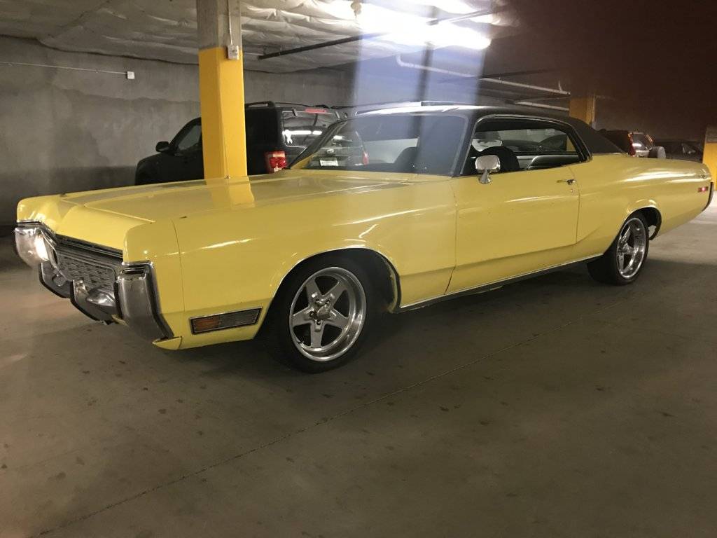

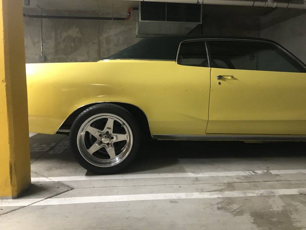

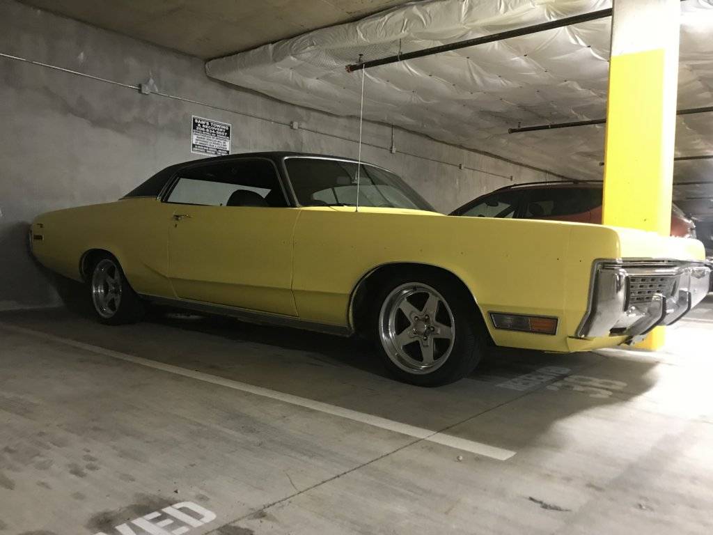

The wheels and tires were bolted on today. The one thing I didn’t like is the front wheel poke. They seem to be way more backspaced than I originally thought. They don’t rub, but they need another 2-3” (that’s what she said lol) spacer installed, and the rear could use a couple inches as well.
The car has a tramline tendency now at low speeds on highly rutted roads, but I’m sure that’s due to the narrower nature of the track width and the wider tires. But... cruising, going fast, freeway speeds.... the car has way better handling characteristics and also way less vibration, almost none, in the entire car compared to before. The Chev caps that were on the car were crazy heavy, like 4 times heavier than you’d think, and a couple of them had major loose internals flopping around. That was the noise at the LF and the vibration and odd things I was getting during speed, braking, steering, as well as a rubbing sound associated with speed.
Anyway. The wheels really made the car. Looks. Drivability, braking, handling, etc.
The exhaust really gave the car some spunk and sound. Getting close!
What kind of spacers can I run on the car that won’t deatroy the suspension or hubs? How much spacer can the car tolerate without major drawbacks?

She's a nice car... but now that they are on... I really don't love the cheap wheels. I now understand that one of the "new" WSW tires had separated... so you needed something. Your car will be more fun to drive with stock tires and wheels. @polara71 wins again...
Good call on the "tramline effect", you made the rear track wider than the front and it's trying to steer the car on road imperfections. I've dealt with literally hundreds of cars with spacers, and in my professional opinion they all suck. The only ones that I allowed to leave my bay are the ones that have a fully machined raised hub (to better locate and support the wheel) and long enough studs, nuts and/or bolts to fully engage and properly attach the wheel. I've seen too many problems caused by poor wheel and tire choices... I'd say look for something with a better fit and skip the butchery to make these work.
BTW, the few customers who I did fit spacers for, did not save $$... just silly wheels they insisted on keeping. Many, many more I never took the wheels off, because I told them up front that I refused to put them back on... until I was convinced they would be safe.
Did the body side moldings come with her? I see where they left the attaching studs on the 1/4 in this picture. If not, you may want to find a set eventually.
I have already expressed my opinions on your carburetor. I am not at all offended that you have your own ideas, but hold onto the take off's... you may want to put them back on someday. My bigger advice is to not fall into the trap of trying to convince yourself that you've made an improvement that "only" requires special instructions to work better. Many folks get so caught up in the belief that something is better , and therefore the "improvement" is working and just needs "___". The blank being tuning, more parts or special driving instructions/technique. Most of us HAVE to make our own mistakes to really learn something, I certainly operate that way... just try not to convince yourself that something is working better than it really is.
OF THE UTMOST IMPORTANCE... when playing with the carburetor swap... if the throttle valve linkage to the transmission is not connected or adjusted right... the transmission will run low pressure and the clutches/bands won't properly engage and get damaged very quickly. It's a painful lesson, if you chose to learn it by experience.
