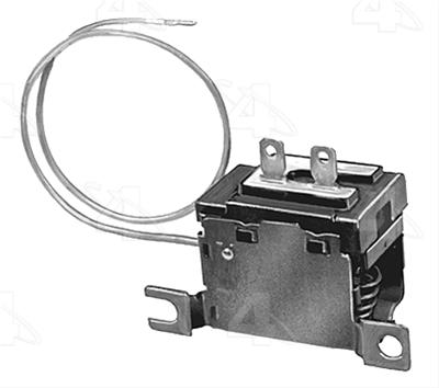

It's called an a.c. compressor cycling thermostat switch. Lots of them on ebay.
You mount it on the firewall, drill a hole into the heater box, and stick the probe into the evaporator fins.
You wire your compressor thru this first.
If the evaporator ices up, the thermostat switches the compressor off to de-ice
the evaporator. When the probe senses above 32°, it turns the compressor back on.
You use this when you remove the EPR valve on the R2 compressor on your 134a conversion.

Thank you brother. You have just helped me out tremendously.
