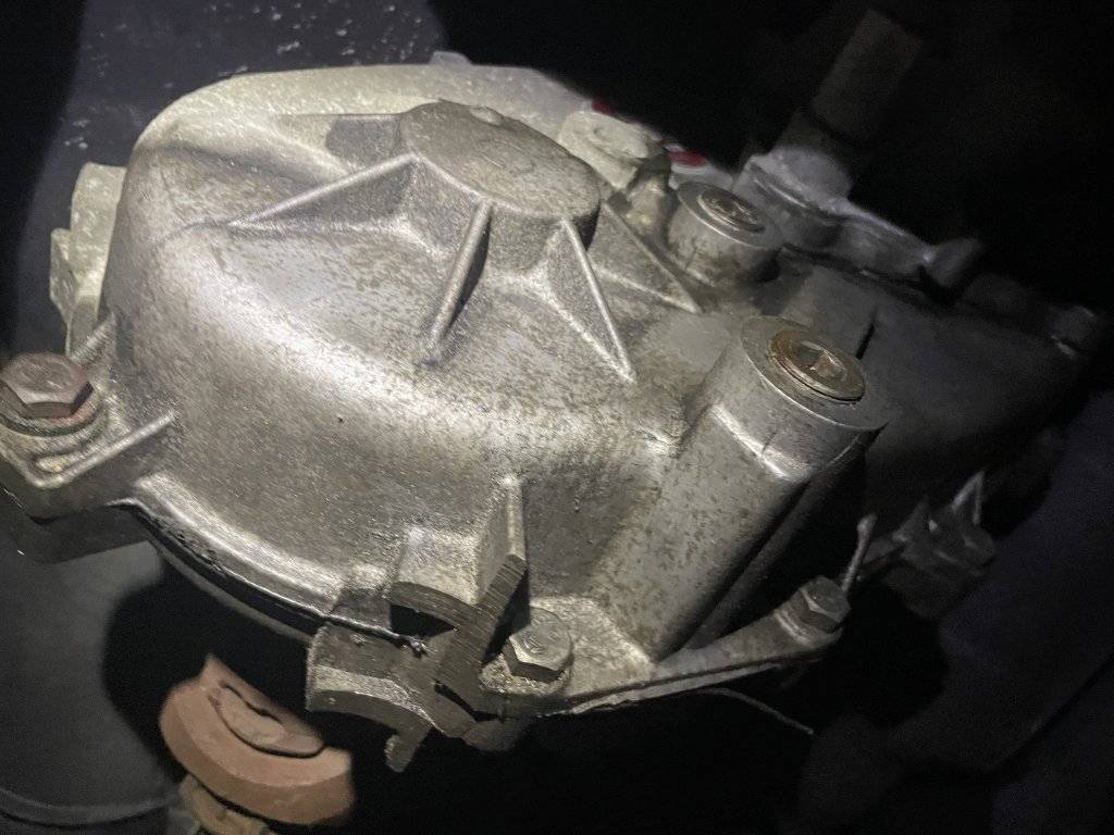

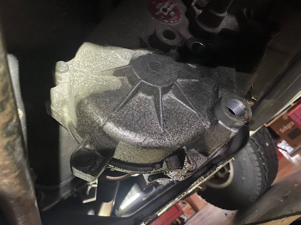

I drained and refilled the transfer case today. It was a little over 1/4” low but pretty dirty. Put ATF+4 in and wiped down the case as good as I could. I’ll be pulling it and replacing seals and gaskets eventually.
I removed the skid plate to access the transfer case and will clean it up before replacing. I’ll monitor any leakage.

Before cleaning
After:
the post wiping down pics haven’t migrated to my iPad yet :BangHead:
Okay edit/uploaded
