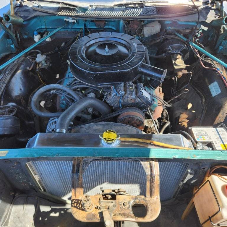

Ok, got it in and test drove it. Temp gauge stayed at the low mark of normal. $143 with tax, I think it was worth it. Easy installation except I had to redrill one mounting hole that was 1/2 inch off.
I've installed 2 cheap aluminum radiators that did not fit at all, but with a little grafting and fabricating they fit and work. I put a radiator for a mustang in my slant 6 Aspen and a radiator for a b-body in my c-body Gran Fury and all it took was some metal plates to connect the flange to the radiator support. As long as the hose location lines up and the radiator flange spacing is narrower than the mounting holes in the radiator support and the height is not too tall it will work, granted you probably won't be able to use the factory shroud.
On this one the factory shroud bolted right up.
