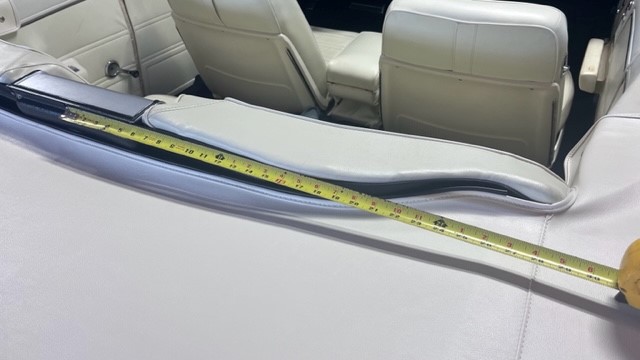

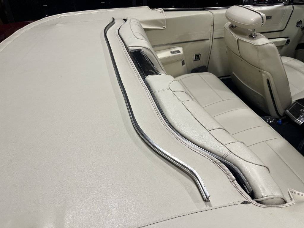

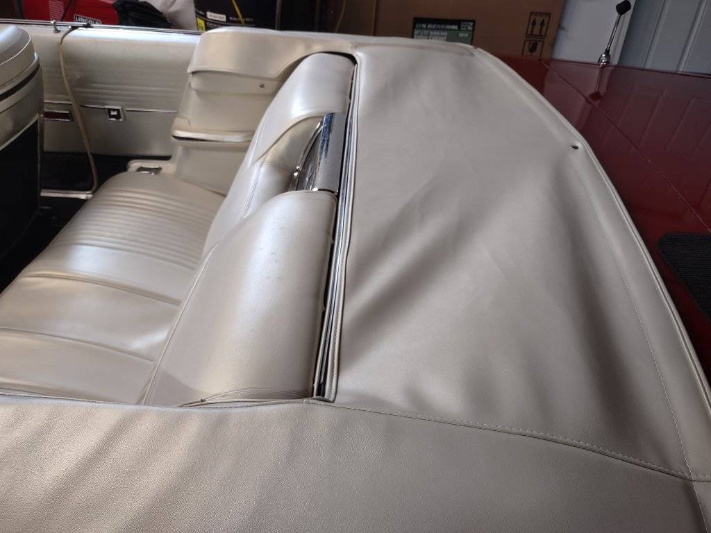

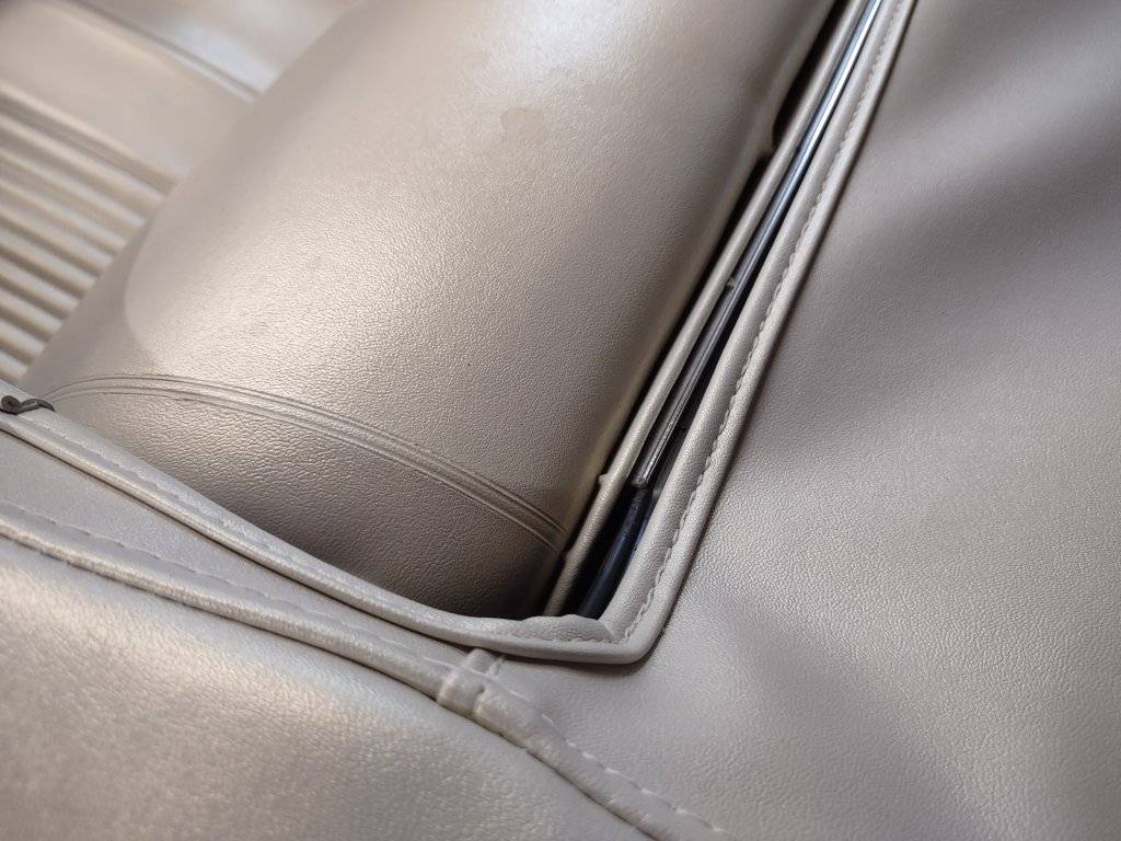

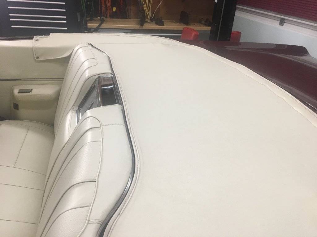

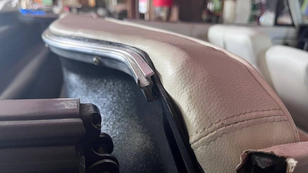

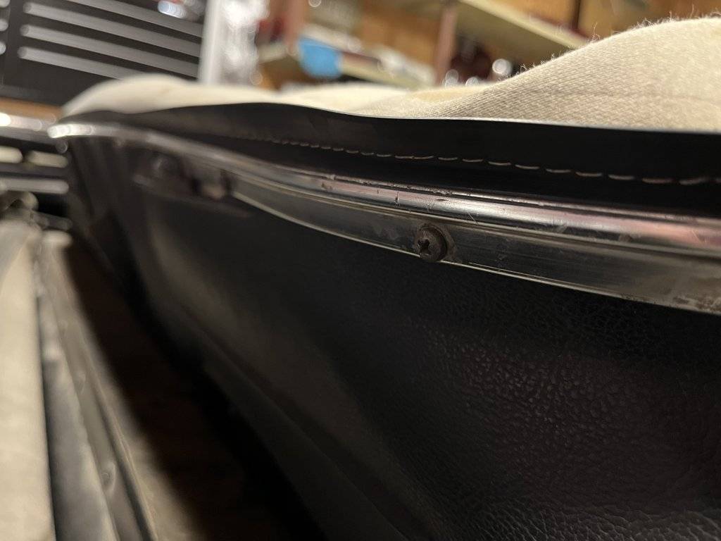

Here are a couple of pictures of my 66 and the boot cover. Note that the slot on my car is straight. Yours probably has a couple of curves in it. That may make it more difficult to slide the bead into place.OK! thanks for that!

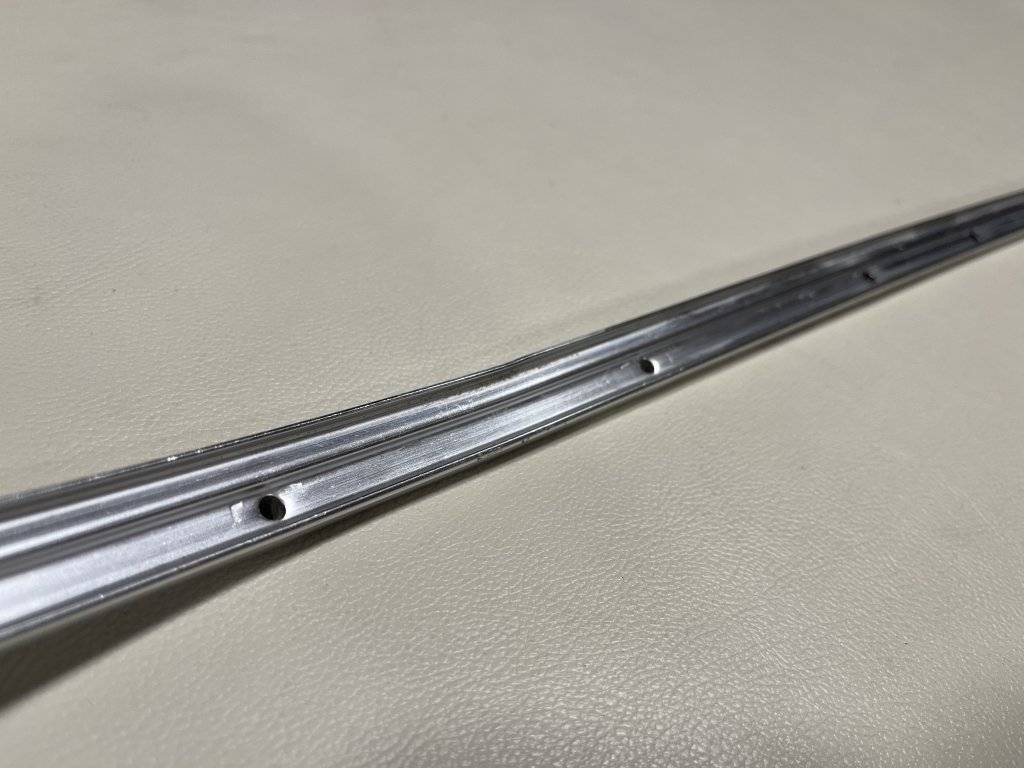

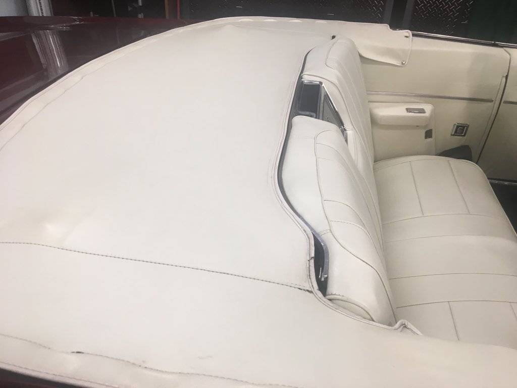

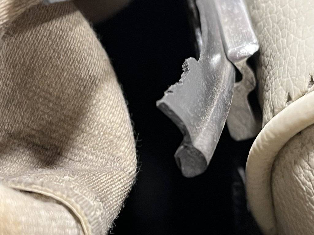

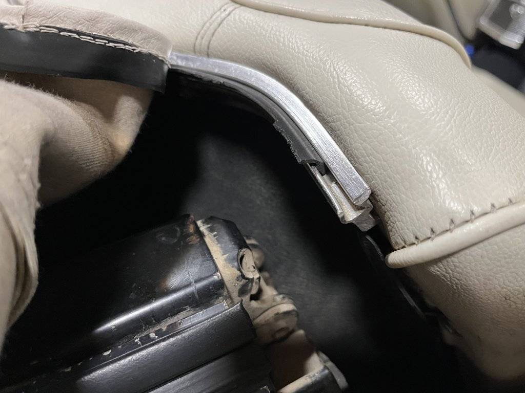

Here’s a couple pictures of mine on the 69 Fury. I’m sure it’s the same as yours.
View attachment 603956View attachment 603957

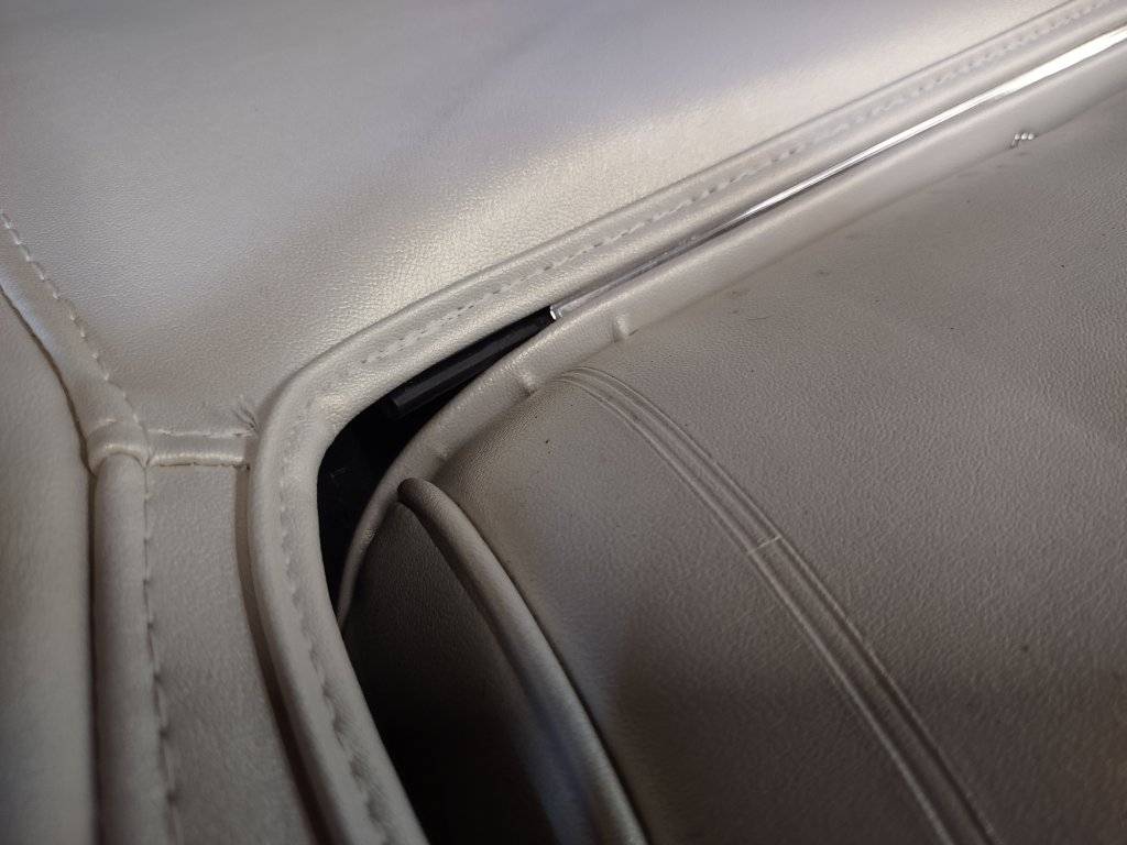

Yes there is a strip along the back of the seat. Mine was an aluminum extrusion that was extremely hard to find. What I originally did was to install snap buttons on the back of the seat where the screws are now. The other half went onto the flap that hangs down from the boot. Worked well until I got the proper piece. You don’t see them so it did no harm.
So I’m not sure exactly where to measure from, exactly where the strip goes, or how it gets mounted since I don’t have any reference. In the morning I will go and take a few pics and try to get some measurements for you. Thank you in advance for trying to help out!Would it be possible to measure the top of your back seat where the strip goes?

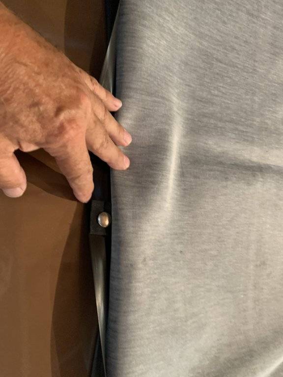

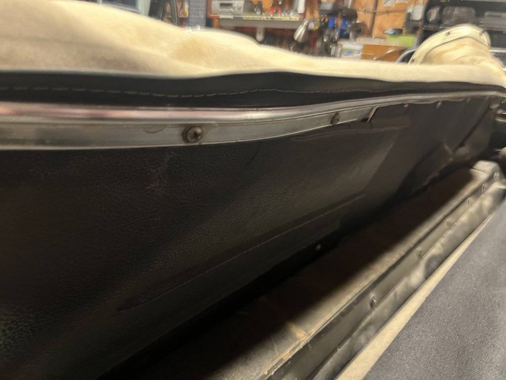

Yeah that’s smart! Great thinking!I got some time to take a picture of the backside of the boot where I put the snaps.
They lined up with the outer edges of the rear speaker. You could put more on if you want. It worked very well.

Correct on the “straight vs curved”. Mine def has contour to it. Prob nothing a little dish soap can’t help out with!Here are a couple of pictures of my 66 and the boot cover. Note that the slot on my car is straight. Yours probably has a couple of curves in it. That may make it more difficult to slide the bead into place.

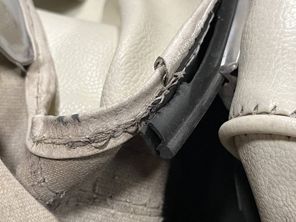

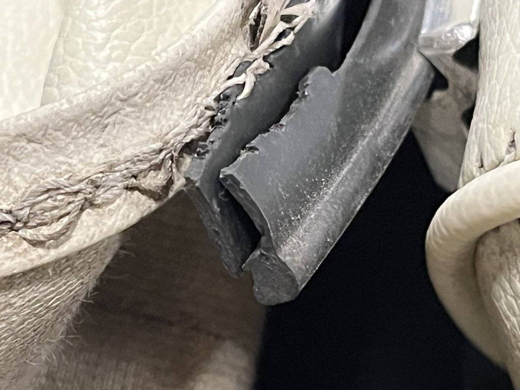

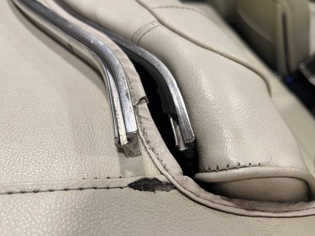

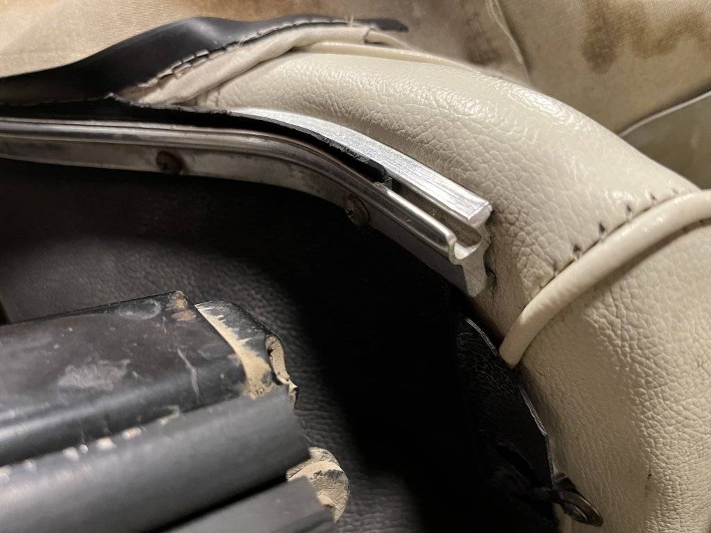

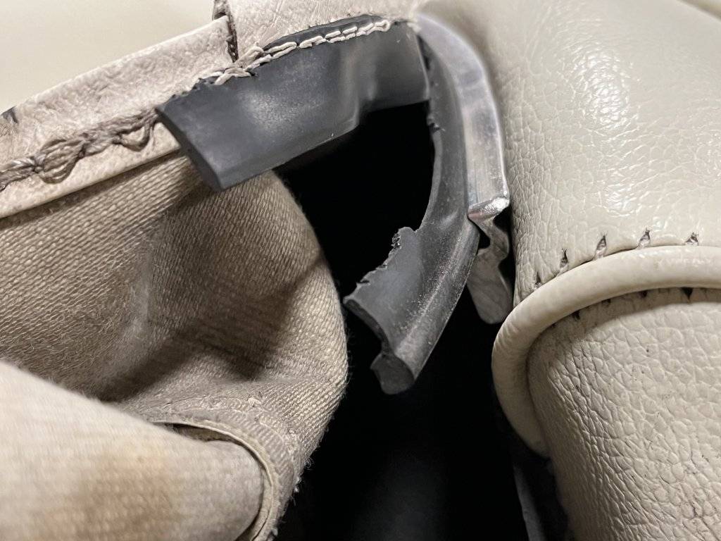

Here is how the boot rubber slides into the trim. As you can see, mine is starting to tear at both ends . Would anybody know where I could buy the rubber strip that slides into the trim? I would like to repair my boot.

IMO that's a great idea!I bought my boot from Legendary. Not sure if they make them or buy them and if they would just sell the strip. It’s worth trying to give them a call. Some others may know who makes these covers and can chime in.

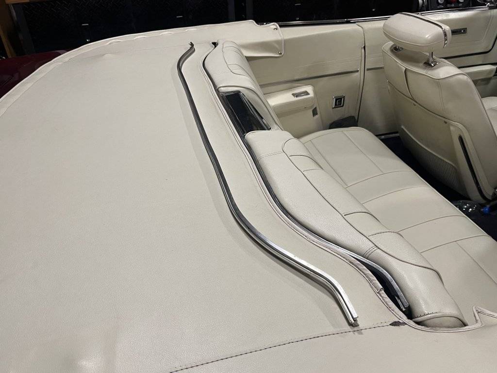

Perfectly! All of the holes lined up with the exception of the ones on each end... no clue why not but oh well... nothing a drill bit couldn't solve! I was actually surprised at the great condition it was in... didn't even have to polish it! TY again!The trim looks great , how did it fit ?
