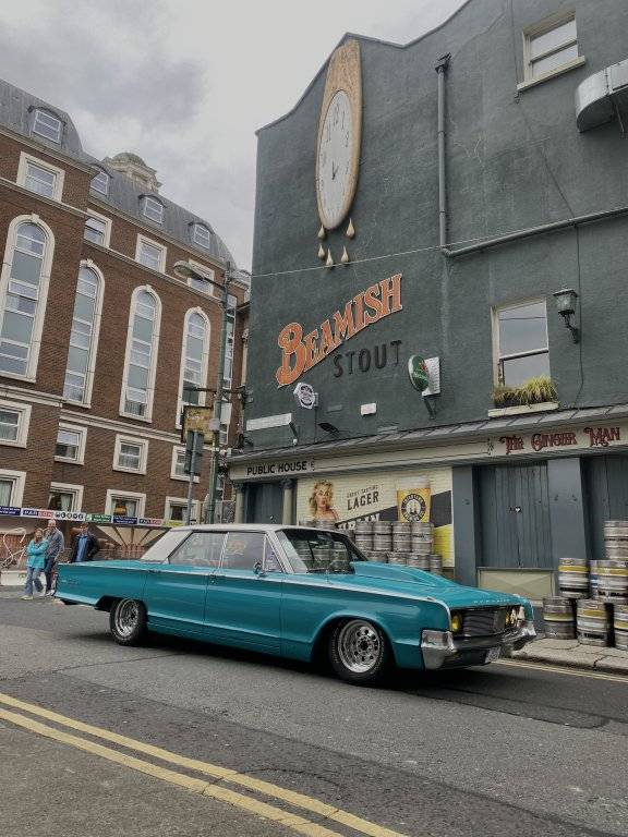

Hi everybody I’m from Dublin Ireland I’ve a 1965 Chrysler Newport 383.
I’m having an issue with my brakes.
It’s got power brake stock drums all round.

Hi. Amazing that you have such a huge car in Ireland with how small some of the streets and roads are there...not to mention the cost of Petrol!

Hi, yeah it’s a big enough car over here and yes fuel is not great, but I enjoy it very much so it’s worth it. I actually got sorted with the issue, I got a faulty master cylinder so ended up getting a replacement in a different brand and I adjusted the pushrod length with the correct tool also and it was perfect thanks

Yeah man, drive that beast with pride! Good to see these cars out and about in Ireland as well. Cheers!
