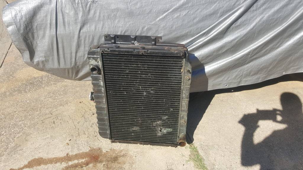

I will send you a wasted 440 + AC radiator and the stock shroud if you will swap straight up for a radiator.

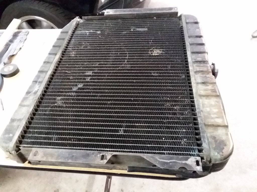

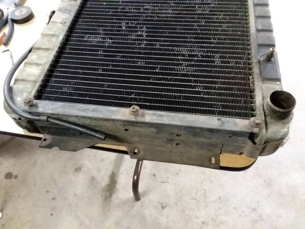

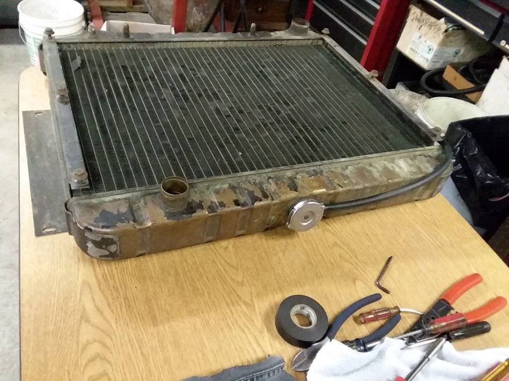

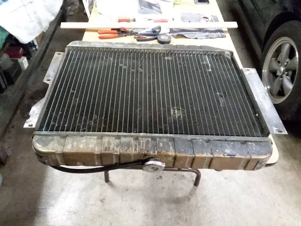

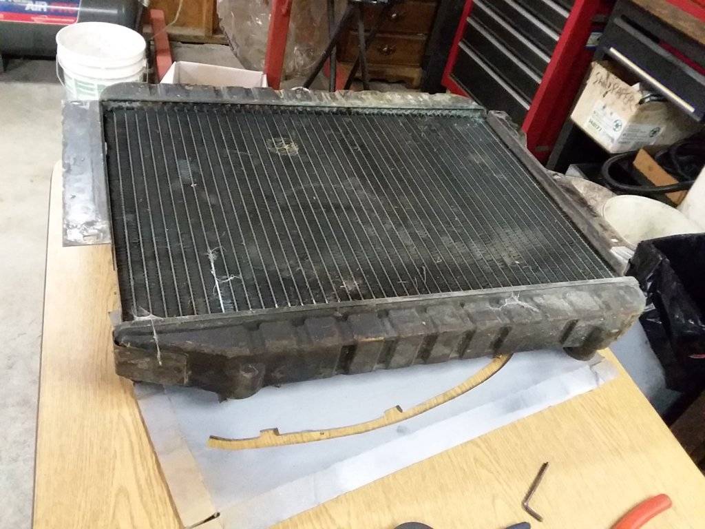

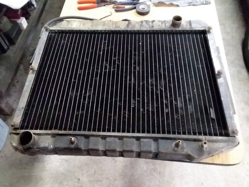

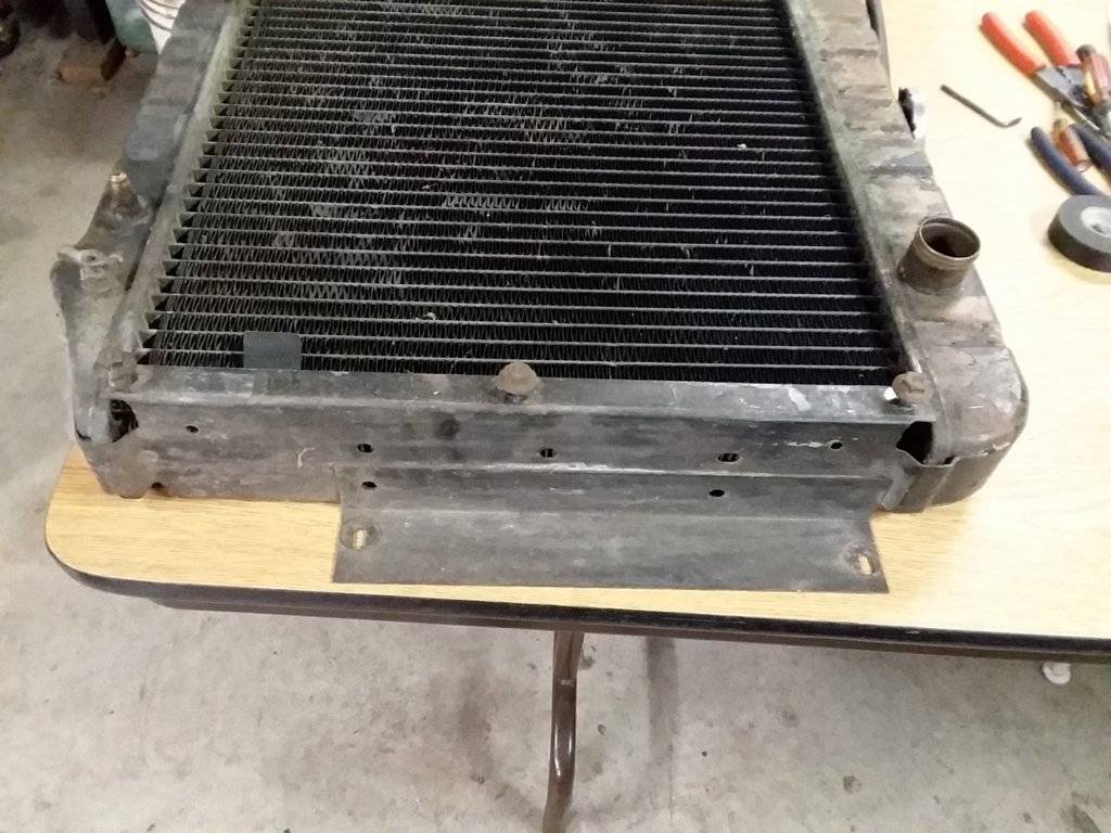

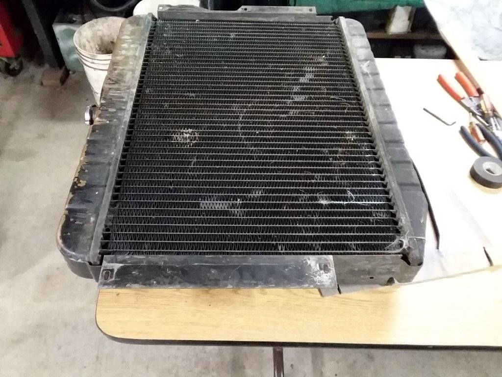

Hi Cold Case
1970 383 Sport Fury Radiator with AC (supposedly)
Part # tag at Core, 1260332, Made in USA. No part #s stamped on tanks.
(Note: did use stock mounts and provide adequate cooling for a stock 1969 440 non-HP motor that was mounted in my 1970 Sport Fury)
Measurements
Core
26.25 inches wide
17.25 inches high
2.0 inches deep
Tanks
27.0 inches wide, upper and lower
3.0 inches deep, upper and lower
2.5 inches high, upper; 1.75 inches high, lower
Mounting Brackets
1.125 inches wide, left side, 2.0 inches wide, right side
Fan Shroud
Mounts 1.0 inch to rear of core
Mounts are 1.0 inch wide
16.675 inches center to center, height between upper and lower mounting studs. Center of 3 studs on each side mounts exactly midway between the upper and lower stud
25.25 inches wide, center to center, horizontal measurement across studs
Ports, inlet and outlet
1.5 inch outer diameter, upper inlet port
1.75 inch outer diameter, lower outlet port
I’m sure that I have left out some measurements that are pertinent. I’m glad to take other measurements if you tell me what they are.

Saylor, 1970furyconv's pics look the same as your unit? Maybe you could inspect yours and see if you agree.
If yes, I would definitely consider your offer. You said the radiator is wasted. Is it twisted? What is the condition of the shroud? If in useable condition, we can confirm both the radiator and shroud fitment for future C-Body owners. Just to confirm, you are looking for just the radiator...not a complete kit, right? If yes, what is your plan for a shroud for the radiator since you are donating yours to us? :)

These pics are excellent. Between the pics and Saylor's samples, we should be able to create a correct version.
