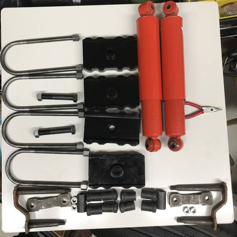

In fact I did. Plus all the rest of the rear suspension parts.
