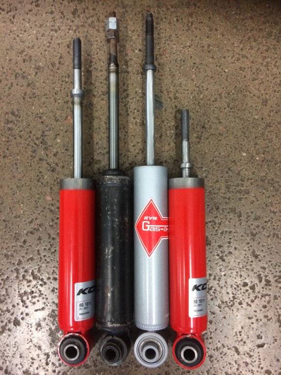

The original '65-'73 C-body KONI front shock, part #80-1742 is obsolete. You can't get them anywhere. But as you may recall, I had a pair modified out of Porsche 356 front shocks, which have very similar characteristics. Almost same performance figures. And as you may recall, I had them all (the Oriflow's, the KYB's and the KONI's) tested in a shock dyno. Just to be sure. And I respectfully disagree: the shocks are not the same. KYB was inferior in the dyno. Original C-body KONI's are similar to original Chrysler Oriflows. Only more durable, and adjustable (to counter the aging of the shock, not to make it more sporty!).
You may read more about it here:
Front shocks, Sensa-Trac or Gas-a-Just?
Here you have the dyno sheets:
67' 300 Shocks

I would be surprised if the valving in the 356 shock was even close to the C body shock, as the 2 vehicles differ greatly in weight, but they may be closer than I think...
Thank you 330dTA for your work. No matter what some one comes along to be nit picky even thought real world technical data was provided.
To the naysayers and cheap seats - See the graphs and below of course the data shows the valving to be little different but the barge will never know the 11lb difference.
Koni # 80-1742: 168 lbs bounce - 449 lbs rebounce (OE replacement, heavy duty shock. Obsolete.)
Koni # 80-1011: 168 lbs bounce - 460 lbs rebounce (Porsche 356 shock, in production.)
Don't be cheap.

Thanks for the info! What mods did you do to the Koni 356 shocks?
Don't be cheap.
