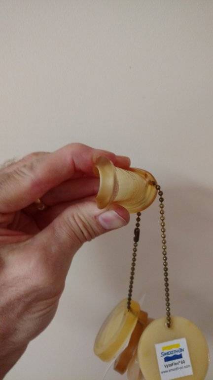

I still think this Smooth-on product would be excellent, but would take some work. You could make several bushings out of sulfur free clay. Then made a mold from that, from there you could use the product pictured to make the actual bushing. You could even dye it white if you wanted to.
