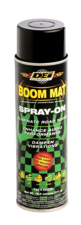

A lot of noise comes from the tyres. You can use spray on sound deadening, Boom Mat Spray in the wheel arches and areas where it's difficult to put butyl mats.
I have watched a lot of videos on sound deadening a car, one of the main conclusions is often you don't need to cover all the panels, the butyl mats to stop vibration and drumming sound. A couple of mats on each panel has a noticeable effect.

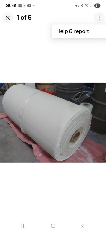

If you use AC, then an insulation layer will save fuel and improve the AC's performance. The ultimate is Aerogel. This is ultra thin and lightweight. Yet provides the equivalent of 4-5 inches thickness of foam. Sold in various rolls and sheets. It's expensive and can be dusty so needs to be covered over.
