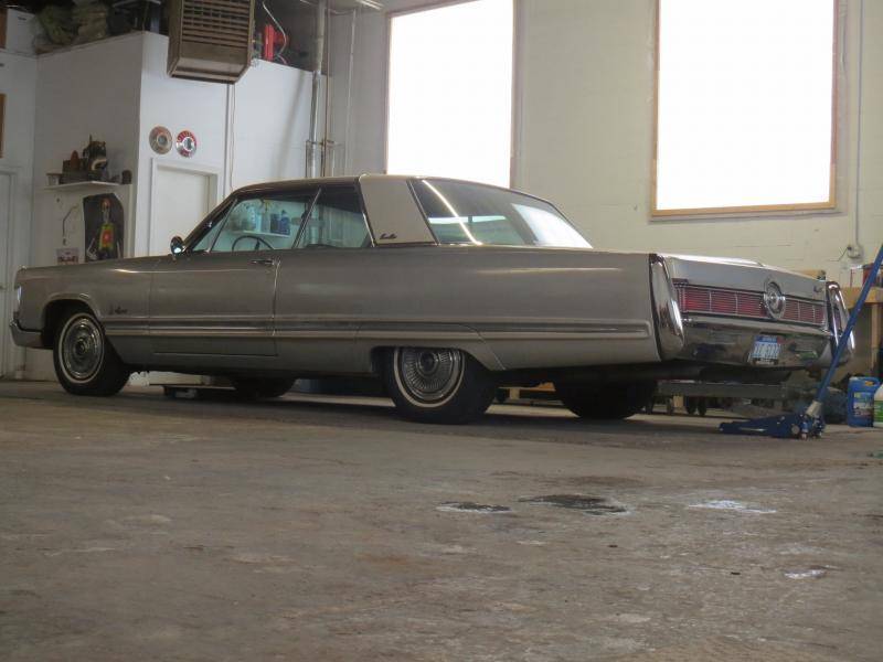

I hear you Stan, my Imp is riding low with sagging rear springs and spongy torsion bar isolators but those are off being refurbed and the leaf springs are next so I think I'll be riding at the factory height by spring.

Cranking the front down is easy - just turn the torsion bar adjustment bolt a few turn until you are happy with the front height. Then get the front end realigned!!! This is not just a "good idea", it's mandatory for a good and proper alignment. Also, do this after you've lowered the rear, so everything is right. I recommend lowering blocks NO MORE than one inch! You can also remove one leaf off each spring for additional lowering, but be mindful that the bottom of the shock is now lower than the bottom of your wheel rim. The edge of the rim is your scrub line. NO PART of the car should extend below this point! If you have a blowout on the road, the shock and mount will hit the ground first, rather than the wheel rim, resulting in one hell of a problem when you start ripping parts out from under the car! Do you have 14" or 15" wheels? If you have 14s, you are going to have to go to 15" or even 16" wheels to avoid this issue.
I've seen c bodys that are supposed to be at factory front ride height, and the front end looks higher than the back end with enough room to throw a soccer ball there. I think there's a fine line in to low, and to high.... In my honest opinion.
