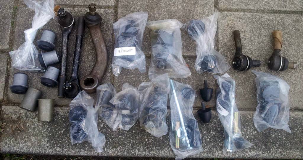

A friend of mine bought a front end rebuild kit for his 1970 Imperial from @PST and I'm supposed to put it in his car next weekend. Despite the remanufactured parts of the kit doesn't look very nice they seem to be in good working order. Only with the Control Arm Bushings I'm not sure.

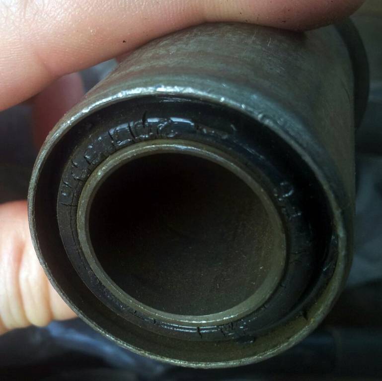

The first ones PST send had a lot of cracks in the rubber already. After talking to PST they've send new ones...

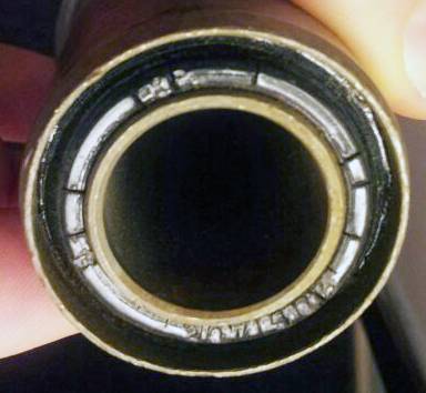

...but the new ones look axactly like the first ones. Cracks all over the exposed rubber surfaces.
Would you guys think they are fine and use them or would you complain again?
I don’t remember my Moogs having cracks but if I were you I would call them again and at least have someone explain why the cracks are there and why they shouldn’t be an issue.
Thanks Matt! That's what I wanted to hear. I'm really not happy with these parts.
I just wanted to hear what others would do!
Changing those out is a big job and one you don’t want to have to do with substandard parts. I did my uppers a year and a half ago and the lowers last spring and I’m still sore...:lol:
I agree. I don't want t odo this multiple times on this car.
But, ähm, sore, ok :lol: I hope I can prevent that ;)
Looks like the rubber has dried out, I wonder how long they have had them on the shelf?
In reality, they could well have been on somebody's shelf for a while. Certainly not manufactured "last week", by a long shot. Minor and shallow cracks I might understand, but the width of those cracks looks a little more like they'd been "used", although they are new.
Makes me wonder what Moog and others are using for rubber? A different or modified-from-oem that might better resist "age-cracks", whether new or otherwise.
I saw a YouTube video (linked from another post?) about a Protectant 303 stopping all age cracks (serpentine belts, etc.) and giving these rubber items much longer service live with "no cracks". Suspension rubbers, if it really works, might be another application?
Please let us know how it works out.

I have these bushings NOS with the mopar part number molded into the rubber and they show no cracks. Not for sale until I use what I need.

Hmmm. Ok. I understand this shouldn't look like this.
I just wanted to hear other opinions about this. So the best is to not put them in and let @PST send some not broken ones. And this is a bummer because they will not be here till next friday...
