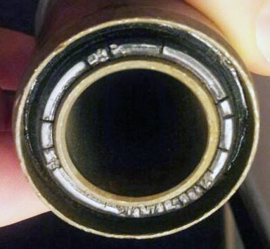

Those are crumbling right before your eyes. I can hear it crunching from here.
It's not that they are crumbling, they are just faulty... I see it just like you all do but there was a slight chance that you guys say it's normal, like from surface tension or something like that. I just wanted to give it a try because of the annoyance with another complain.

Just a little update: PST responded and told my friend the parts were NOS and because of that, they were shot...
He was told the parts were the last they had and now they have to order new ones... What may take a while. :BangHead:
Besides of all the trouble we had with complaints, multiple international shipping, customs and so on, I think PST should have never sold them, nor ship them without inspection. Especially NOS parts that were on the shelves for a long time. And in our case, especially as an internations customer, where an exchange is much more difficult and time consuming.

An NOS pitman arm might be fine. Anything NOS with rubber in it from 40 years ago like a bushing, door weatherstrip, or motor mount is never fine.
