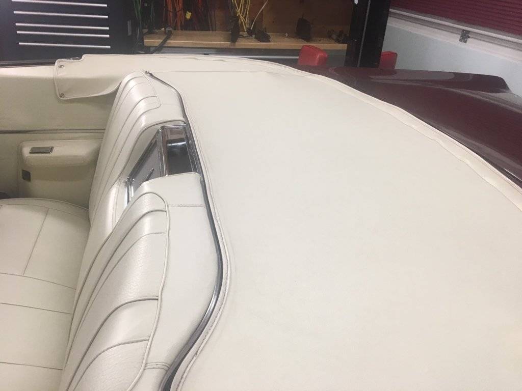

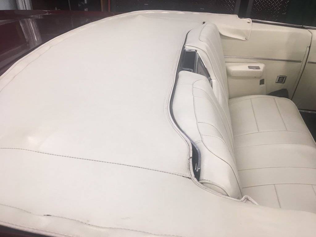

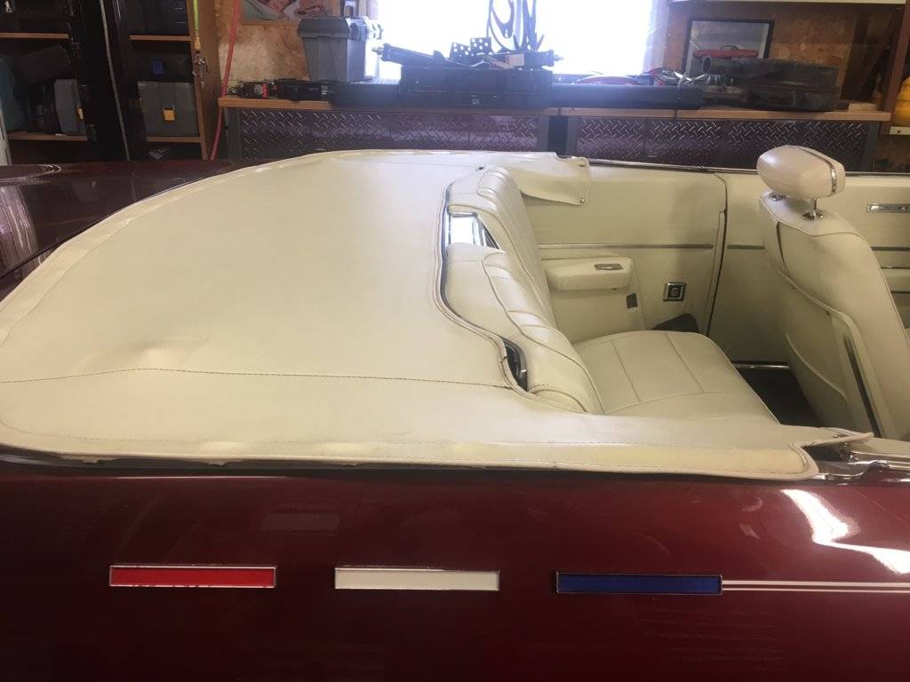

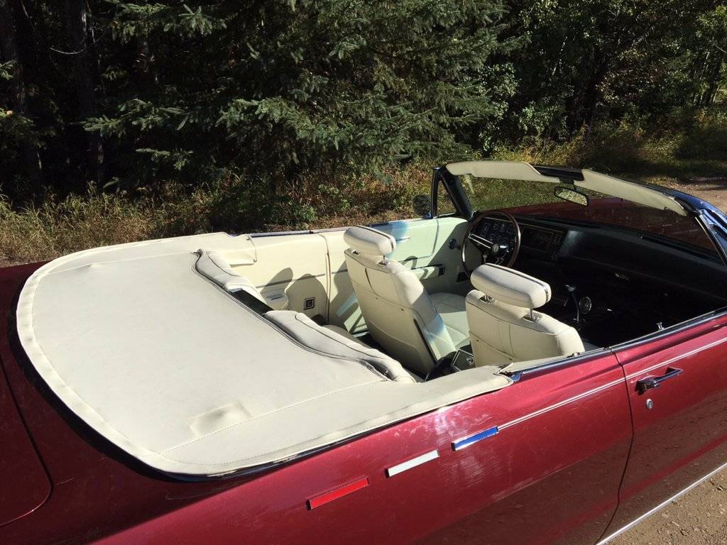

I agree. There is a small aluminum channel attached to the back of the seat that the boot attaches to. You can see it in the pic of my boot at the start of this thread, you can also see the rubber tearing away from the boot in the same spot. My boot is about 15 years old now, I should get that repaired.

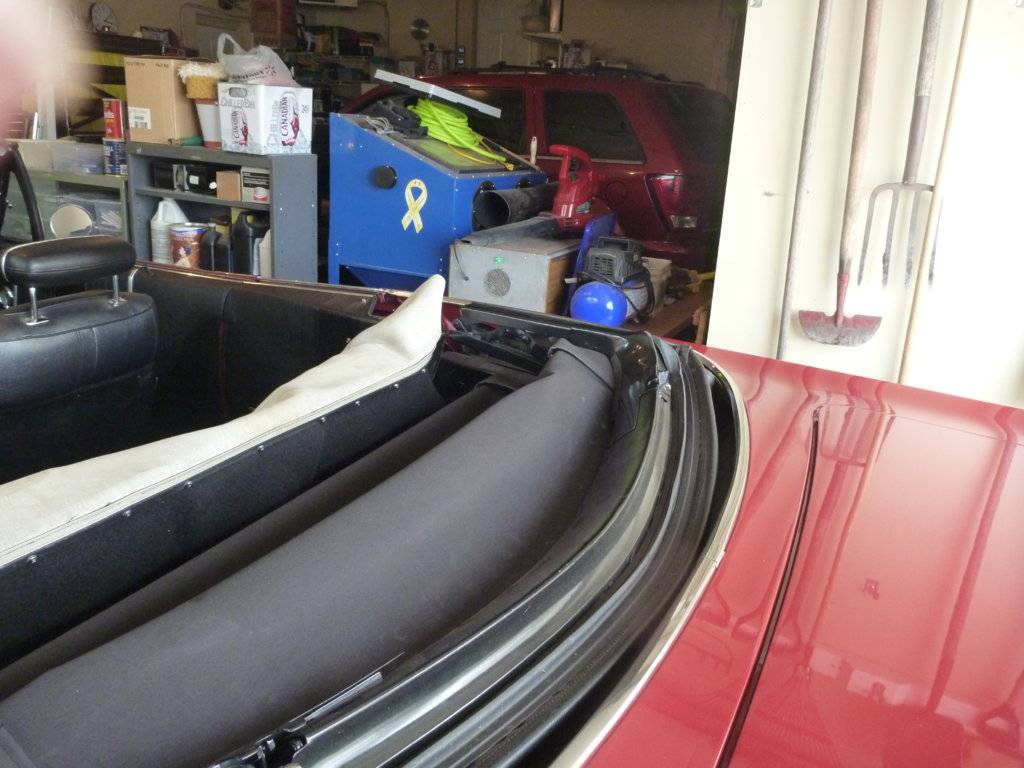

Yeah I'll make a video next time I'm at the storage place. All I have to hand is this, what's interesting is it's down slightly more than it seems to want to go now, just on the left side of the picture below - I wonder if the roof is just folding incorrectly - I haven't taken apart or adjusted anything in this area since the below was taken. I've been storing the car with the roof up - is this the right thing to do? I saw another while looking at this and the roof was so stiff it was still about 5 inches poking out of the top.

if your top sticks up too high on one side ,either the top was installed incorrectly or the mechanism is out of adjustment. does it raise and lower evenly or does it want to twist? this might be enough of a difference to keep the boot from fitting correctly.
the idea is to slide the boot into the channel on the rear of the seat. next you fold it over the seat and when the top is down, over the stack ( the lowered top assembly). then attach it around the perimeter with the plastic clips and snaps on the interior panels. in order to raise the top, you would unfasten the clips and fold the boot over the rear seat. when the top is up, fold the boot over the seat and lay it on the well liner while still attached to the seat.
having said that, i wouldn't suggest doing it that way unless you are absolutely sure everything is dry. any moisture in the well liner or under the boot will cause mold or mildew. at the least, an unpleasant odor.
Here is a picture of the rear side of my rear seat. You can see the alum strip with the tonneau cover slid into the top facing channel. You can also see the dome fasteners on the rear face of the strip whee the well liner snaps n place.
Note also, when the top is lowered into the well, the folds should be smooth and the roof stack should finish with the side rails horizontal.
My car has a glass rear window and the weight of the glass helps to form the roof folds as it lowers. I had a '68 Fury vert with a plastic window and it was a bit of a bear to get it to lower especially if it was cold.
My boot is from legendary. It is a very snug fit. It has to be stretched on while clipping it to the trim. It’s best to do it when it’s hot out, it’s much easier. The proper way is to start clipping the clips on the trim from the middle of the back ( center of the trunk ) and work your way to the sides evenly from the center 6 or 7 clips at a time. If you clip one entire side before the other side it will pull the boot over to that side and it will make it difficult to clip in the other side.
