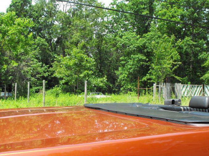

Above you can see the clips under the boot clipping under the molding That is the original boot on my car and is date coded with the plant location on it

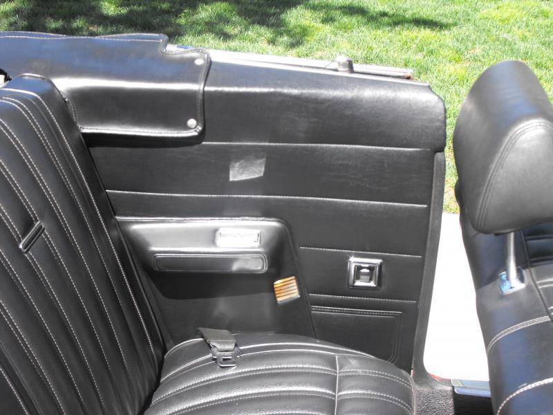

Below are the only snaps on the boot or the only snaps that should be on there, at least on the 69s and 70 Cs
