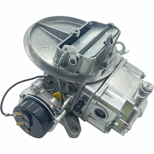

New China, but they work good. eBay/Amazon. Spead bore, square bore. Whatever. Pick your flavor. May need choke and throttle connection kits, probably will.
Or if you need a big block two barrel. Something like this.
Or maybe this for small block.
Search till you find what works for you.
