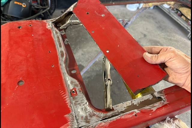

I have a Bee-Cool radiator that was too big for the opening, I think it's a 26" radiator, but I didn't measure it. It made no difference to me, It fit between the battery and the right frame rail. It came with a notch cut into the tank for the right frame rail, approximately 3/4 of an inch deep. To take advantage of the entire radiator core, I had to cut 4 1/4" from the opening and moved the original edge back and welded it. It looks like it could have come from the factory like this. Well, at least to the guys that aren't on here :) .
Here's some pictures, it really wasn't that difficult to do.
This is where it started

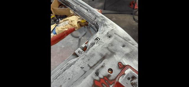

Then I cut 4 1/4" out of it. Here you can see I moved the original metal at the opening back. I used some of the metal I cut out, to fill the gap.

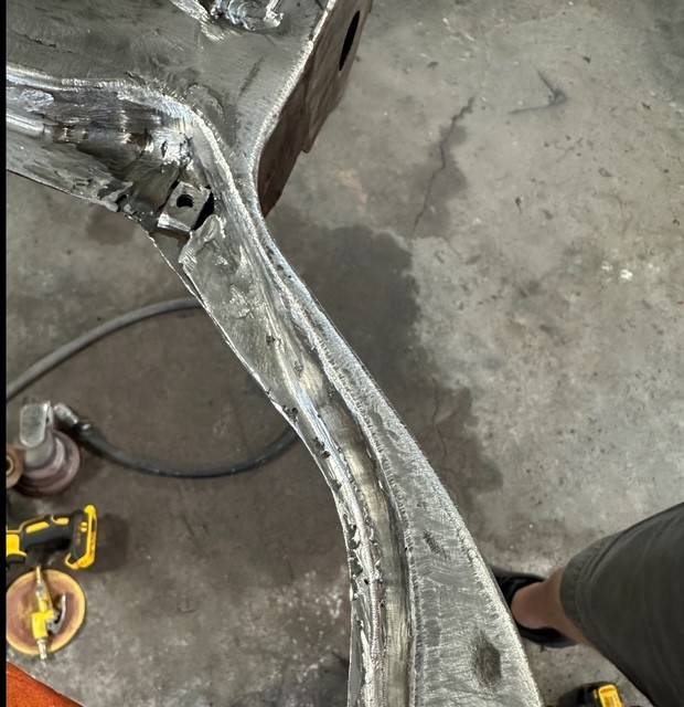

Here it is welded.
View attachment 692174View attachment 692175View attachment 692176
It's thin here, but not a problem.

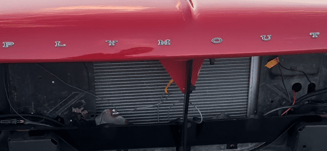

Here it is primed and installed so I can fit the condenser, drier, and put holes in it for the hoses. Then it comes back out for paint. It's the last part to paint. You can see the opening is large enough now. I still need to make a shroud for electric fans, I'm running 1 large one and a smaller one because I don't want to have a cooling problem. I have a 140 amp alternator and there's an American Auto Wire Highway 22 plus harness installed so the fans and all the other electronics are covered without any wires getting hot.
