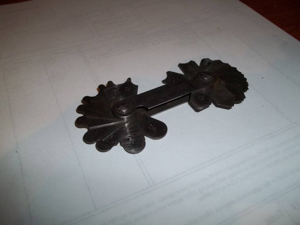

Big_John you are right. Why is this of importance? In reference to a quote from CBODY67 above (the correct radius of a fillet of a crankshaft) this is the gauge tool that is used for checking the radius of the crank and also checking the radius of the stone on the crankshaft grinder. Hence the tooling to do the job right at a "shop built engine" as opposed to one done at a mass assembler. More care and detail goes into a shop built engine. Just my opinion and observations.
