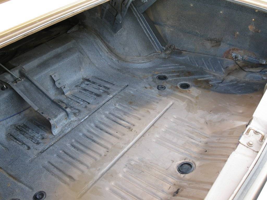

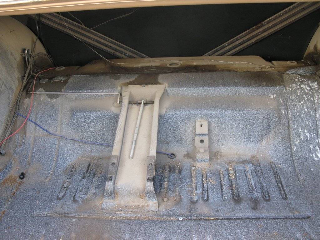

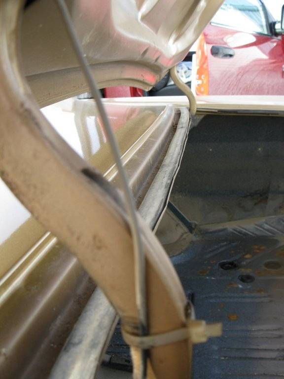

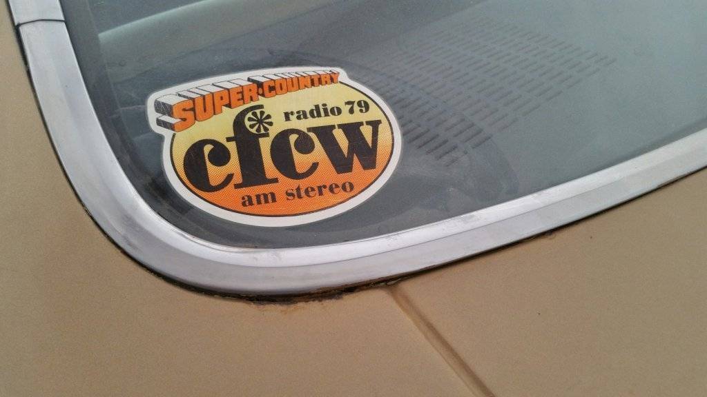

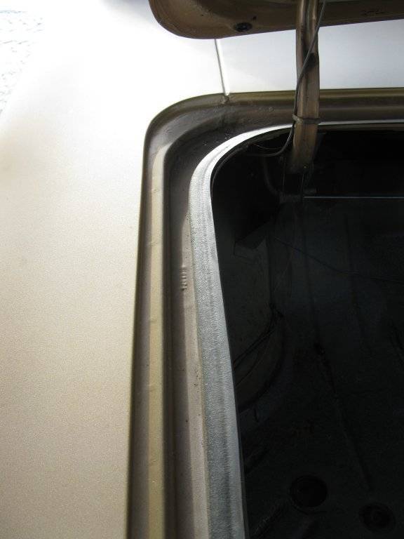

There's very Little rust starting at the edge of the rear window glass, just to Keep an eye on it.

...was also nice to see l don't have to ...do anymore rust repairs to a dutchmans panel
If I were you, I'd check into that spot there on the left under the decal. Looks like it's working it's way to an eventual repair. On any of these cars, I'd probably pull the back window and scrape out any surface rust and coat with Zero Rust or some heavier coating as a preventative measure.

ya will be definitely pulling rear window trim and cleaning up those areas...that little spot under the sticker is the only spot on the back window that theres a issue...bottom line is the vehicle will never see inclement weather again so is just a mater of cleaning up and dealing with any present issues and vehicle should be good for many years to come.
as for vehicle info was amazed that everything from day one was still with vehicle..the previous owner took great care of the vehicle and is now up to me to see to its needs and see the car survives me and makes it to its next caretaker down the road

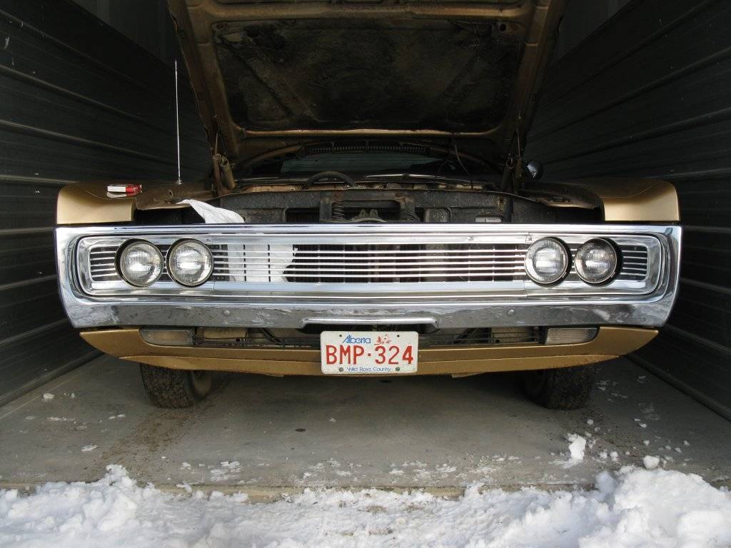

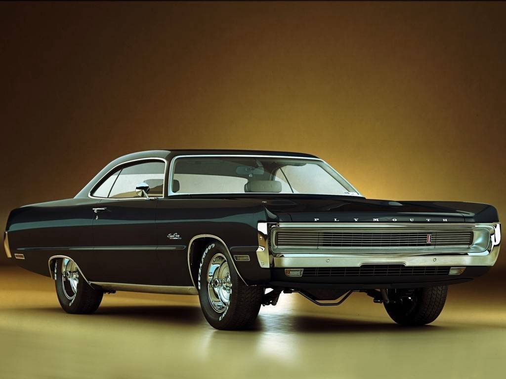

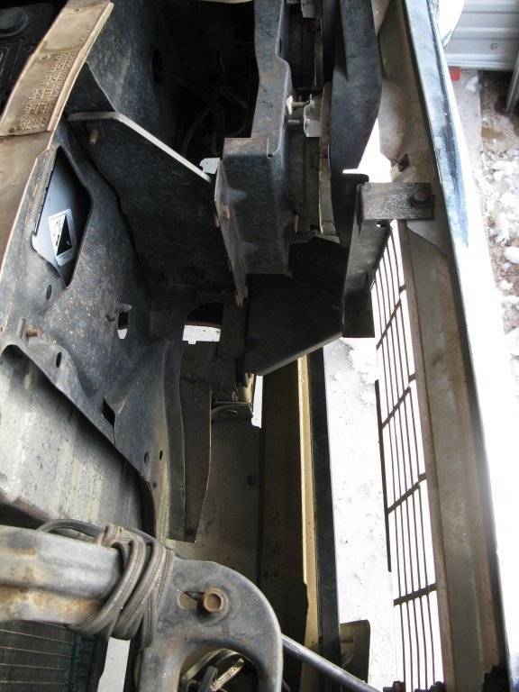

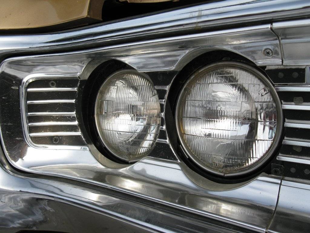

in swapping from the standard grill to the hidden headlight grill is there anything l need to do to the headlights or there mounts to make a hidden headlight setup work?
will get motor and bar ect and center support looks to have holes for motor bolts so short of wireing dosnt look to bad to switch over...from what l understand bumper has to come off which is okay as it gives me oppd to clean up front end
Seems to me I ran into a slight problem with the headlight buckets. The hidden vs open grill types use a different bulb setback. I do have a bunch of light buckets so you can pick what you need. Measure from the rad support to the bulb face on your car and compare it to the GT. I used 71 light buckets since they are also setup for optional bulb washer/wipers. Be prepared I always say!

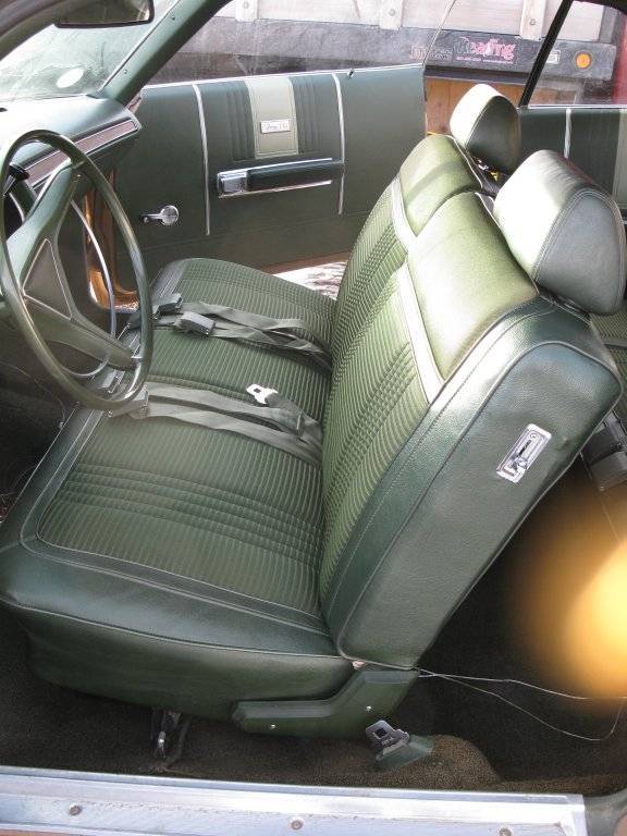

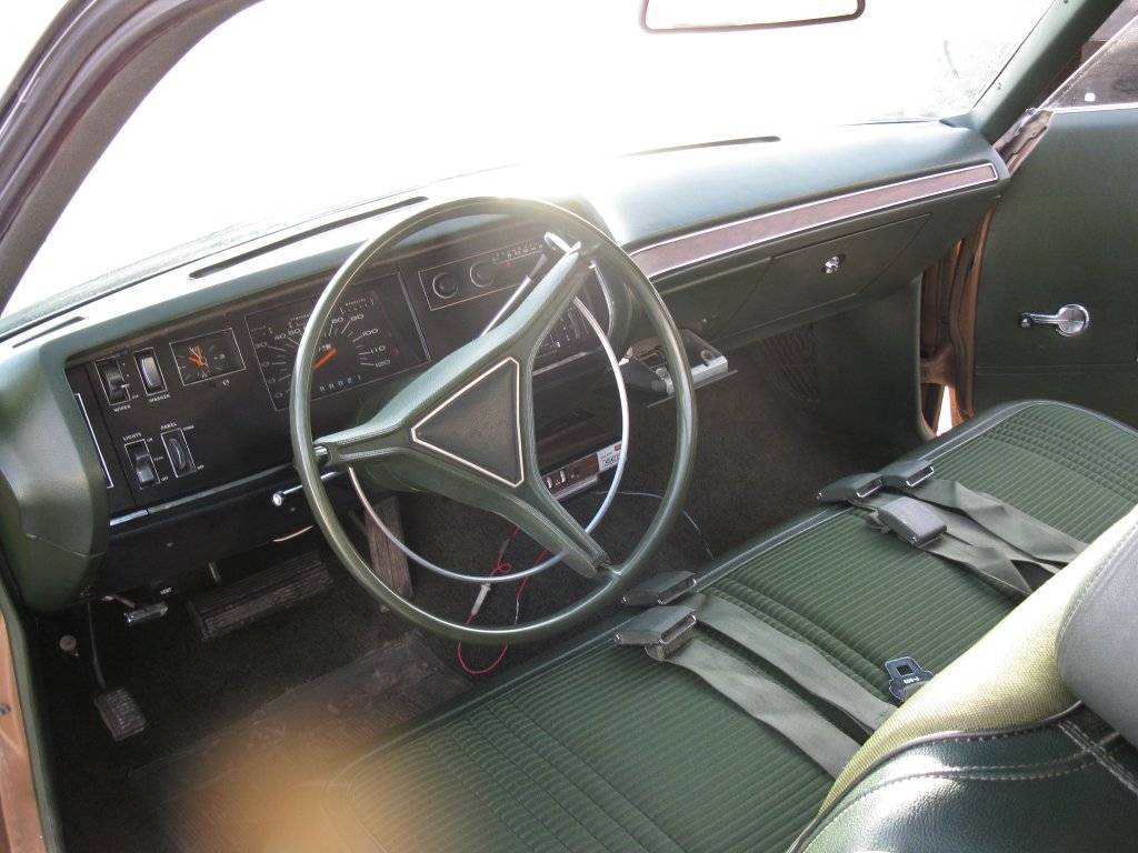

I understand your dilemma, too nice to change, must be saved/preserved as is. But it's better to start your build with a nice car less metal work, parts chasing, etc. In the end it's your car and I will follow along no matter what you decide. Good luck.
I guess I'm the only one here that would make a triple black sport fury GT clone out of that one. You probably won't find a better starting point then what you've already got. Keep all the original parts and if the next owner wants to change it back to Mr Boring Green Interior then have at it, otherwise you still wouldn't have scratched that itch.
Thanx....bringing it home to work on over weekend...will get measurements and check back with ya

honestly if interior had some issues would pull it in a heartbeat and have at it...have actually been considering building a dunk tank so l could dip seats whole and dye cloth black and use SEM landau black for other interior pieces and vynal
70 would definitely make good starting point but honestly just needs cpl basics and is done...are lots of vehicles out there to do up a triple black 70 fury in the future...case in point still have the 71 parts car that's in pretty good shape yet

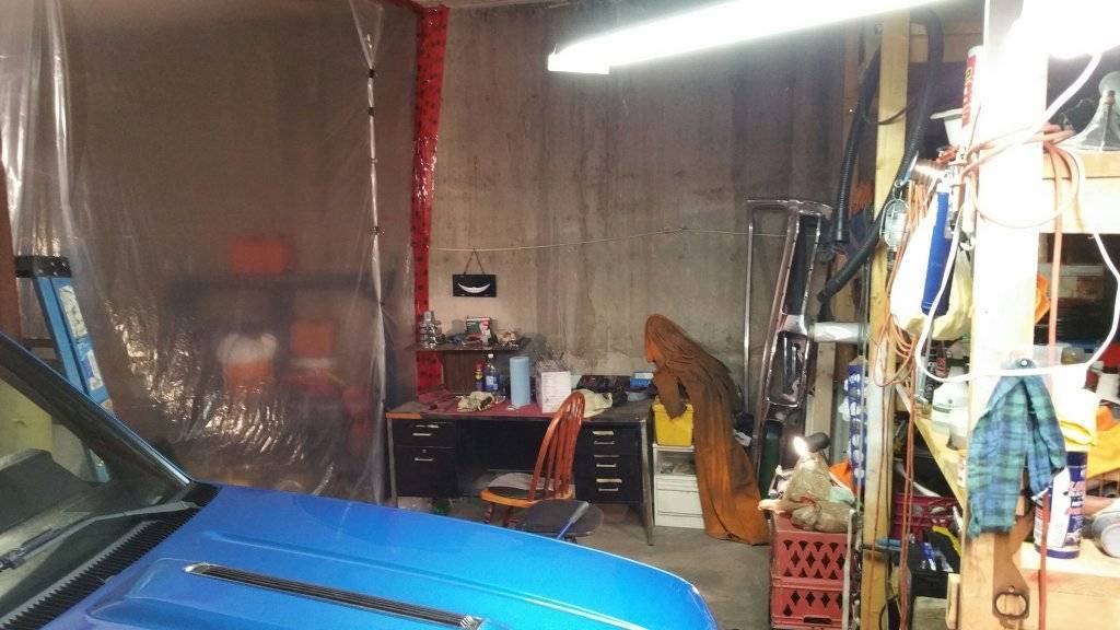

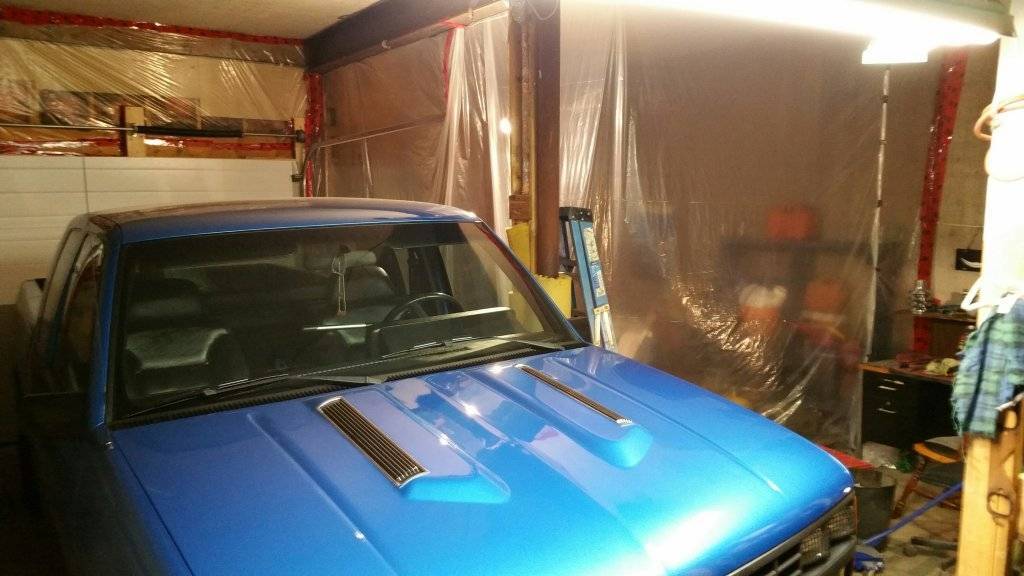

been runnin about all day...youd think it was night before xmas or the wife was bringin a baby home....not quite but have been prepin my little garage for the -40 Celsius winter that's shure to come as well as the 70 fury tomorrow...am bringin it home to play...its my turn dam it!!!!!!
l plan on spendin the next 4 mnths in the garage cleanin up the 70 for next spring and lm pumped...l live fer this ****...for me its a simple pleasure

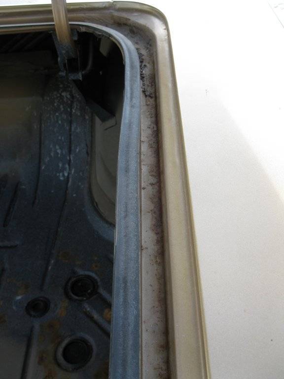

G.new front window...remove trim on rear and deal with as nessasary

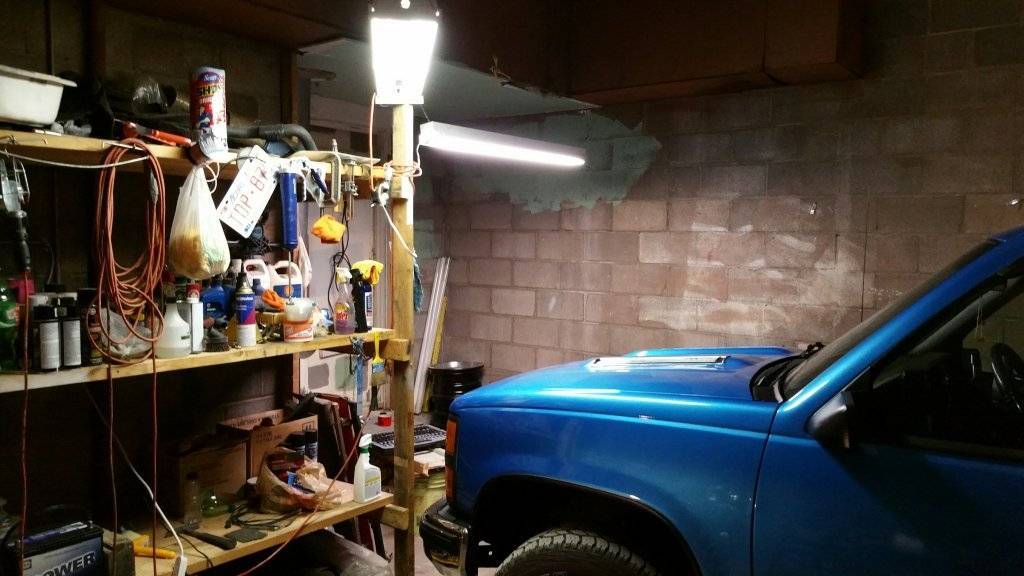

M. all in all have some fun and get off my *** and this chair this winter...spent all day cleanin and prepin garage and putting up plastic to help keep heat in area l'll be spending the winter in.....may have to bring down a micro wave oven
luckly they pipe heat into this little garage to keep pipes above from frezzein so with the addition of a little 1600 watt barrel heater from local princess auto and lm rockin...

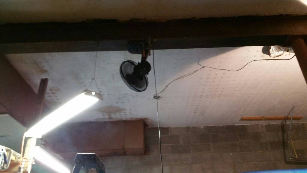

also found a great little working fan someone had thrown out behind the BFI..wiped it down and hung it up to help move air about the garage...free ****..all good...lm golden ..time for this critter to hibernate for the winter..snows a comein
