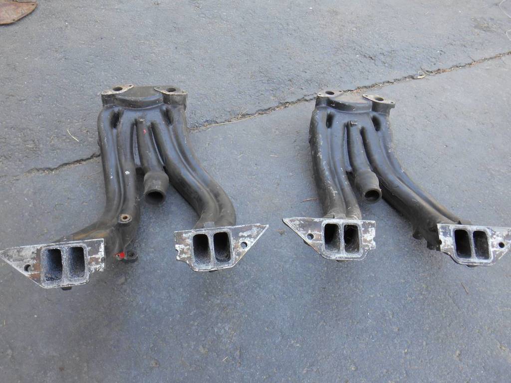

Let’s all get on the same page with the terminology.
Those beautiful intakes pictured above are called Long Rams. They came on 1960 and 1961 361 and 383 Dodge and Plymouth’s, and 413 Chrysler 300’s. The 361/383 and 413 intakes are identical with the same part numbers.

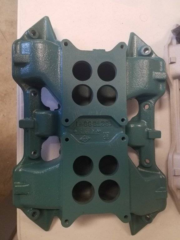

below is a picture of a cross ram intake, it is one piece and just like any one piece intake the pay are different for 383 and 413, or B and RB engines.
for those that want to say this is anal. No, this is correctly identifying what we are talking about. Thanks!
This is what I thought you meant too Lol!!!
Cross ram vs long ram. Thanks for clarifying I didn’t have a pic handy.

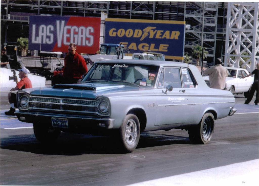

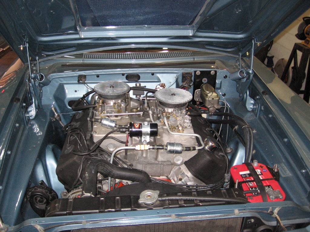

I had this set up on my Hemi when I was racing.Mopar Performance.After putting the car on the street I went with the single 4 bbl.Reason ? I just could not keep my right foot off the floor.
Just a side note to any fuel related installation. Hard plumb as much as you can. I'm not a believer in rubber hose. I use it to " mock" up installations and then bend the appropriate fuel line to complete the project. And remember to install the nut before making the flare....:rolleyes:

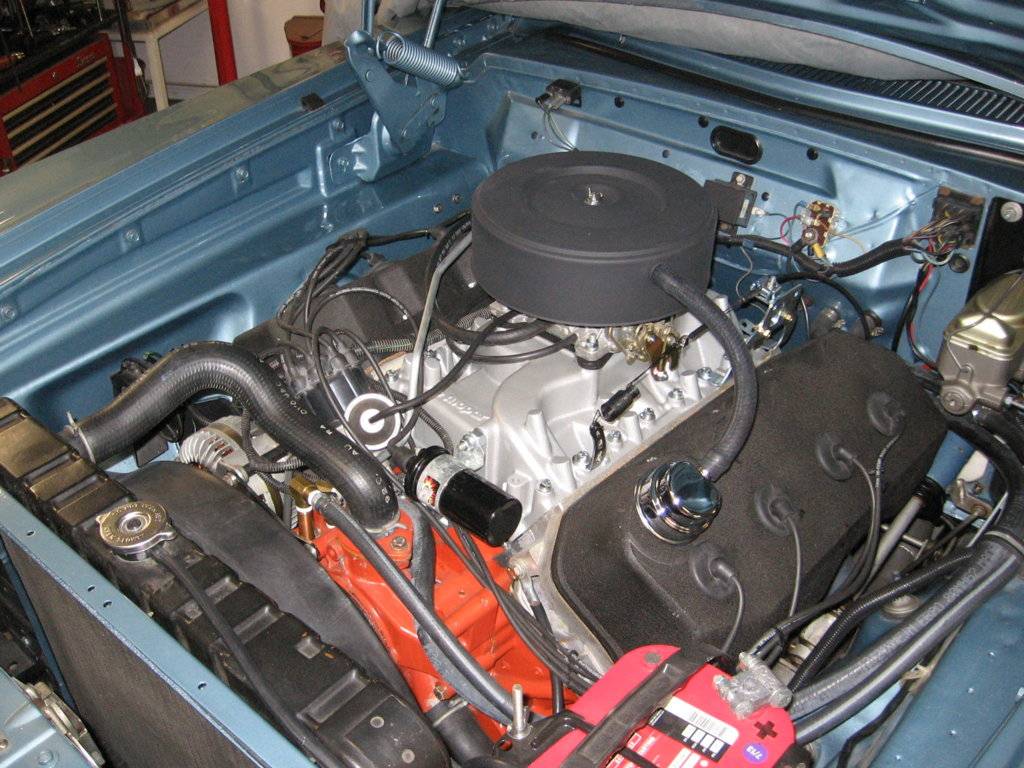

I had this set up on my Hemi when I was racing.Mopar Performance.After putting the car on the street I went with the single 4 bbl.Reason ? I just could not keep my right foot off the floor. View attachment 365912 View attachment 365913
Please post a few pics of the whole car. That preview engine pic is great, the rest of the car has to be greaterer...

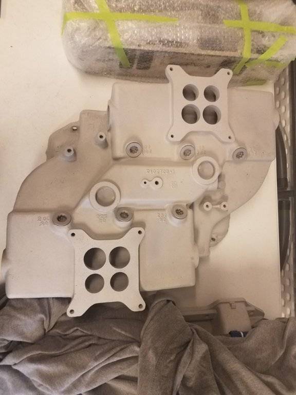

How about the Offenhauser 5206 intake? I have a matching pair of Holleys that can go onto it, but not sure if it is compatible with a 64/65 413 engine. Finding the linkages is going to be another pain in the ***, but that's what Google is for.
I'm dreaming of a sleeper build, just need some good resonators on the back to tune the sound.
The "long ram" that I was looking at has cracks that need substantial repairs and I don't want to mess with it.
