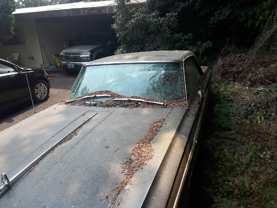

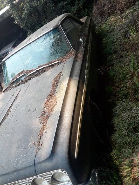

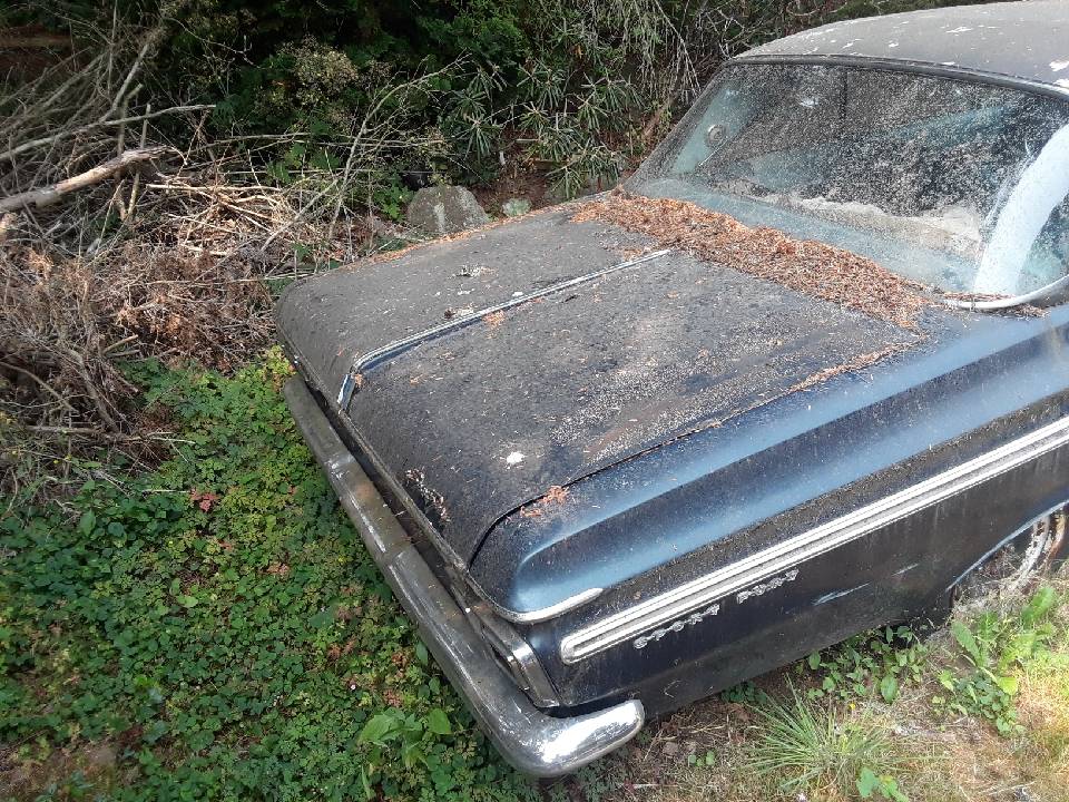

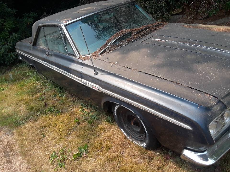

wow! Thanks guys! What I unexpectedly nice reception. Looking at the car you’d think it wasn’t anything special, but of
Course as I looked closer I saw the rarity and beauty of the car.
Once I saw the cue ball (shifter), the interior, the plates, and the red/white/blue decals I knew it was a very special car. I have no plans to change ANYTHING whatsoever, I just want to get the car running and give it a serious comet wash and cleanup.
Please any information on how to handle this with the Mopar (club) if you will, please let me know how to handle accordingly so I preserve the importance and the cars rare nature to beat make sure it stays what it should be. Again I’ll post a plethora of pictures and information so you guys can take this extraordinary journey with me. Thank you for the kind posts and welcome,

Yeah, I’ll lift everything off the paint and interior before I do any cleaning. Normally I would pressure wash engine bays and door sills, but this car is rare enough I will make sure and be gentle. Is it smart to post the VIN here on FCBO, or should I keep most of that info private?Try to vacuum of as much of the pine/fir needles as you can prior to washing the car. Pine and fir needles tend to get packed in the wiper cavity and the cowl. When wet that stuff gives off an acid as it decays, so look for rust anyplace there where that type of debris piled up on the car. Keep a pressure washer away from any aluminum trim as the metal is soft and pressure washing will damage it.
