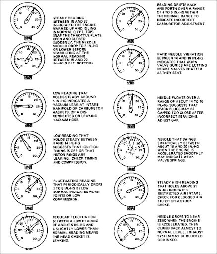

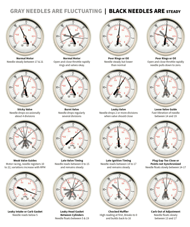

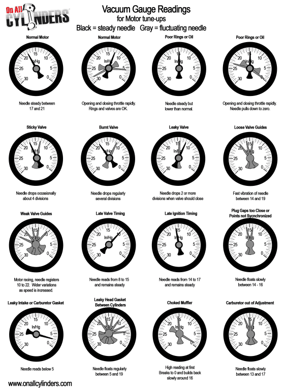

Before you do anything else, Hook up a vac gauge to the power brake booster and observe. Note the inches of vac at idle and 1500 RPM. Does the needle fluctuate and does it worsen at rpm increases. Then proceed w/ a wet dry vac test. Observe if you here excessive air in the Intake, Exhaust or coming from the crank case.
The first thing you should do is a compression test. May be a leakdown to further diagnose.
Vacuum gauge will tell alot google vacuum gauge readings. Scope would definitely tell you what is going on but doubt there is one near you that knows how to be used.
