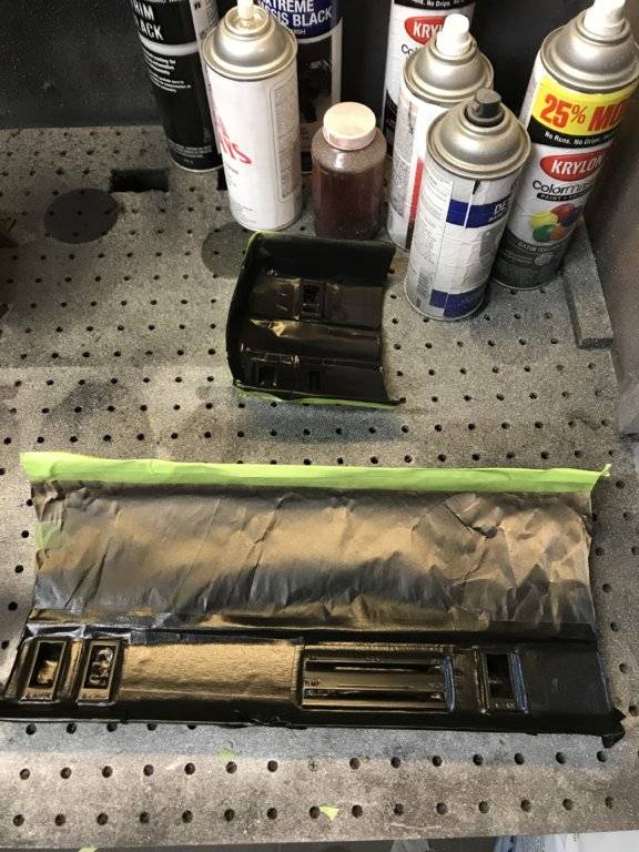

I had my dash panels re chromed back when MR. G’s did them 10 years ago. It seems back then there wasn’t much on E bay but now they show up quite frequently for less than the restoration costs. Any way I got them back and it looked like a third grader did the white lettering. This was after I had already sent them back as they were detailed like the ‘67 dash ( a lot of silver)and after loosing the little panel that is removed for a fader. I was not going to send them back again.

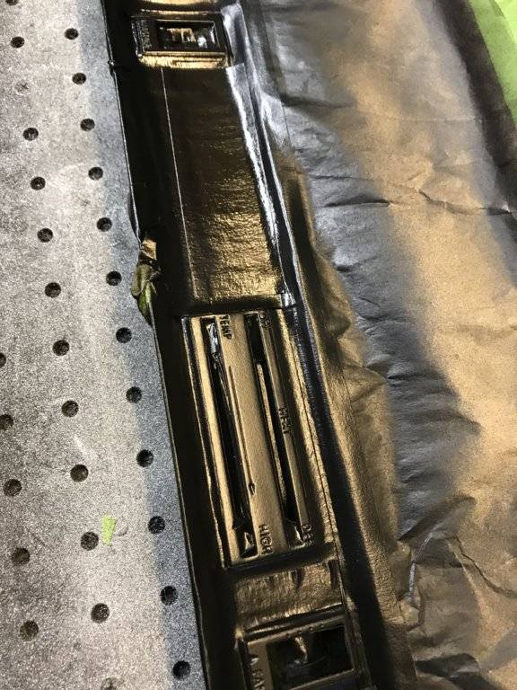

So now w am going to touch them up. I tried to clean up the excess white paint, but it took the black paint off.
I masked everything and repainted the black on top of the bezels and let it cure a while. My dilemma is to get the white paint in the letters and wipe off the excess without taking off the black. I need to maybe find a different paint type that I can easily wipe off without solvent.
