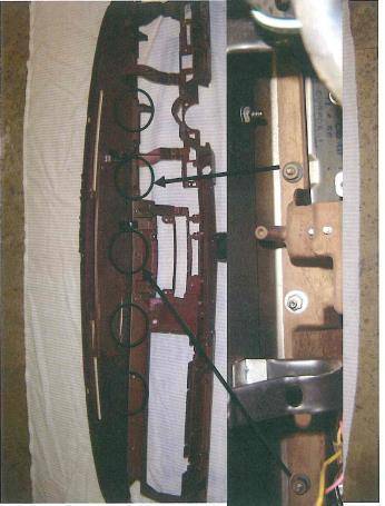

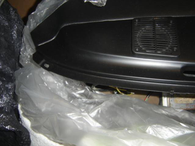

I pulled the windshield, there is 6 bolts that hold the filler panel to the balance of dash. With what you already pulled it should come out as an assembly. Be prepared, the whole thing weighs 78 pounds. (I have done 2 dashes like this)
If you leave windshield, you might be able to disconnect the bolts - they are 3/8", but could be really tough to get at.
(I put together a bunch of pictures in powerpoint with notes, I am travelling right now, might be of use to others)
Good Luck
Hope this helps, these are the screws you need to get at laying on your back (pull seats)
This will separate the die cast portion of dash from filler panel. However, not the easiest way to do it.
Good Luck

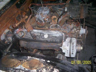

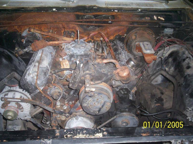

Thanks guys! I managed to pull the windshield out today and got access to the bolts that held the dash in from the top. It turns out I actually needed to remove my dash due to an engine fire from the previous owner. The heat did some damage behind the firewall where the ac unit was located. It melted some of the vacuum lines running into the ac unit and also melted the defroster vents below the dash.Nothing else got damaged as it was mostly restricted to the engine bay.These are pics of what it looked like when I got it.She's all cleaned up now but I decided to take her apart and redo her anyways.001.jpg027.jpg
