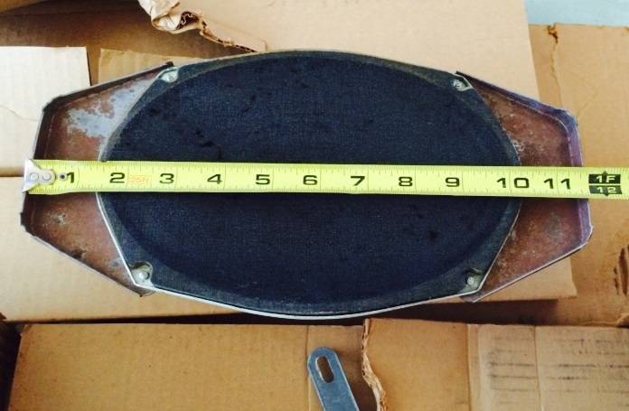

I purchased a direct placement from Rocketrestorations on e-bay .they sold a dual voice coil speaker but said it would not work well with my factory AM/FM radio as it is 4 ohms and the dual voice coil is 4 ohms for each coil x 2 = 8ohms. single coil cost $34.00 haven't had a chance to install it yet. size is 4 x 10 and came with new mounting hardware.
In my 66 New Yorker it was a 6x9 with 2 metal brackets that adapted it to the dash. When we upgraded the sound system , my wife cut out a plexiglass piece that would screw to the two factory brackets and allow the install of two 4" square speakers. Took a couple of prototypes to get the correct fit. She cut the plexiglass on her table top laser.
MarkS: I had an original radio converted to AM/FM/Bluetooth/USB. It should be on it's way back to me this week.
66NewYorker and Commando1: You are both right. Here's a picture of the speaker that came with my radio. Looks like either size could be made to work.

Retro Sound makes this 6x9 speaker that has separate tweeters for each channel and is pretty thin. It should work well with your conversion. I have one in the back of my 300 Vert and it's decent for sound. 6x9-Inch Ultra-thin Dash Speaker
Good info, looking to work on the speaker issue in my '66
K. I. S. S. Buy a 4x10 speaker adapter and go nuts with whatever way you want to go. About 6-7 bucks.
His opening is 6 x 9 if I'm reading this correctly.
It's a good alternative and I'm sure an adapter can be bought or fabricated. I did a 4 x 10 out of some scrap MDF for the front speaker in my 300.
It's a good method though and I'm sure something similar could be fabricated or bought.
I installed a 6x9 in my dash as well as in between the rear seat in my '65 vert. The 6x9 fit under the dash without issue. I only needed to relocate my remote trunk release in the glove box due to the larger magnet.
