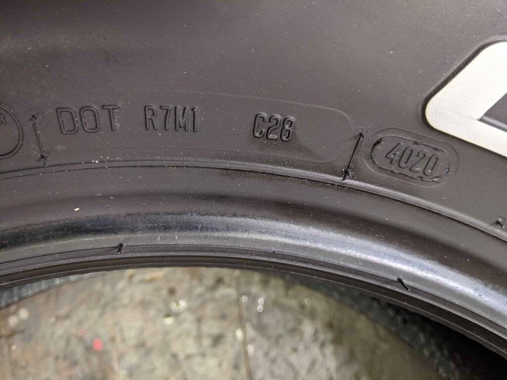

For cars made 2000 and later, look for the 4-digit DOT code, Month/Year. 4020 means 40th week of 2020 is date of production.
For tires made prior to 2000, DOT code is 3 digits, 2 digits for week, 1 digit for last digit of year, so 202 may be 20th week 1992. 3 digit tires are double max allowable age.
