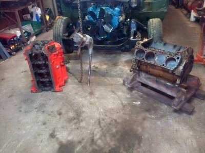

Got them home and found I had not one, but two 1973 440's! which go as follow;
3698830-440-8, RV stamped on pad, 4-12-73 production date, Forged Steel crank with 3641371 balancer, 3751213 motorhome heads, Standard bore.
3698830-440-8, a number letter sequence stamped, will need to clean up to ID, 3-6-73 production date, cast crank machined to match connecting rods, 30 over bore with new connecting rod's, pistons and rings, '68-70 906 heads with a port and polish, block has been line bored and decked.

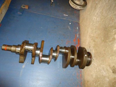

I dug through the parts and there are two good cams, one from the motorhome 440, the other an aftermarket beefy cam from the orange engine, I have all kinds of parts. Including a 187 C body oil pan and pickup.
I would call this a success. I plan to use the RV 440 as it is still standard bore and has the steel crank.....

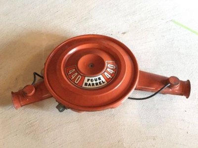

Air Cleaner from a '74 Plymouth 440 Cop car....

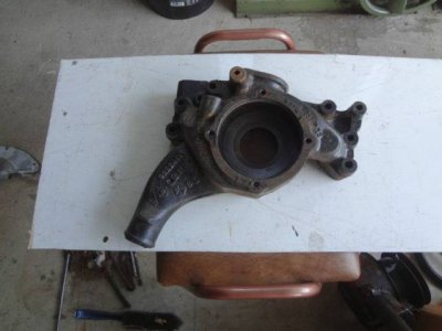

'73 440 waterpump housing, 3698468

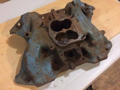

'73 440 intake, 3698444

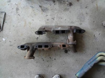

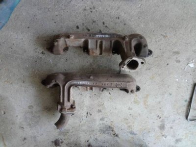

'73 440 exhaust manifolds, P/S 3751074, D/S 3698546
Good enough, I won't say the exact amount for everything listed I will just say less than $250CAD and the majority of that is the Air cleaner.

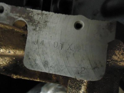

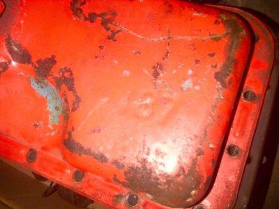

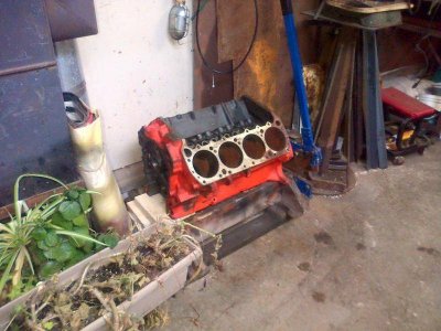

So in the process of cleaning things up for reassembly in the .030 orange block.....
And ended up cleaning the ID pad on my keeper, the Golden virgin......
J-1973
440- CI
T-Truck (RV)
X with Maltese cross- 0.010 Undersized crankshaft
5-May.
8-Day
2- second engine built that day.
The '73 Fury was built June 4th, this engine was built almost exactly a month before.......the gold on its block is even almost the same as the gold on its upper control arms and calipers when I bought it.
I would say it was meant to be

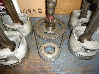

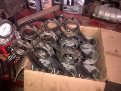

Which engine are the rods in the picture from? Sorry I lost track.
Those internals are from my .030" 446, cleaned all of it up after sitting in boxes for 4 years.

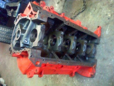

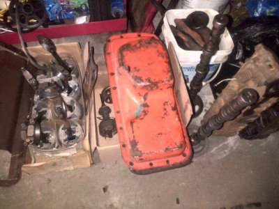

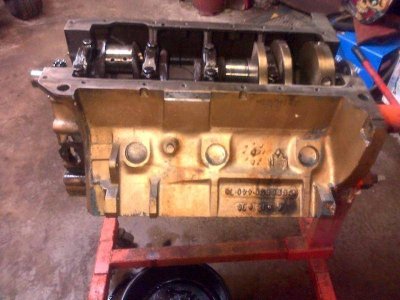

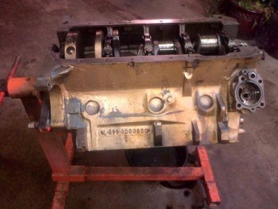

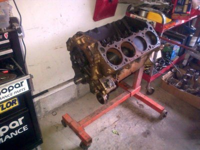

Anywho......decided to dig into the gold 440 and see what I had to work with, besides I can't do anymore on the '69 till I get a few parts for it.12341214_10207998474217106_732633513420172312_n.jpg12342651_10207998474257107_4243292846117507123_n.jpg12360075_10207998448176455_7974165832528593059_n.jpg12373405_10207998446256407_3456543184510662951_n.jpg

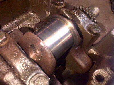

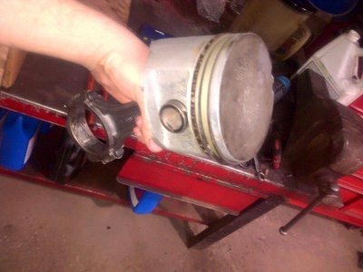

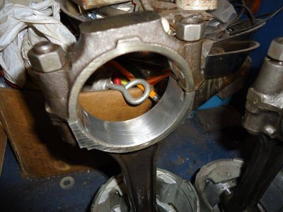

De-greased it completely on the outside, found no more numbers on the side ID pad, not that I expected a serial number on an RV engine. I did however find when I popped the pistons out that this engine has been rebuilt and well maintained after the rebuild. So, new bearings, a hone, and she'll be good for lots of Smiles per Miles.

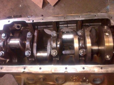

Tomorrow I'll pull the crank and inspect the main bearings and cam bearings.

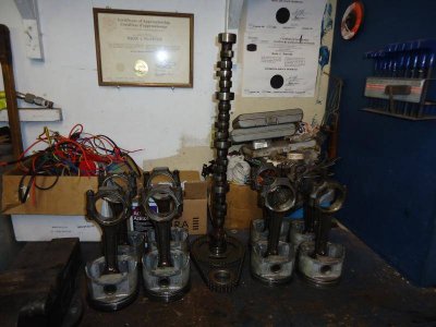

I tell no lies, brought home the tools I needed and took what was left apart. Hot tanked the pistons and oil pump cover at work too.
12342676_10208005290827517_7601070346255835397_n.jpg12360272_10208005290787516_4013604709977237038_n.jpg12366492_10208003047931446_2832599374411224544_n.jpg12342279_10208003047891445_2845431939219427292_n.jpg

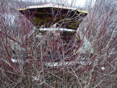

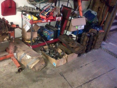

I also found this on the weekend..................half of it is coming home with me...
