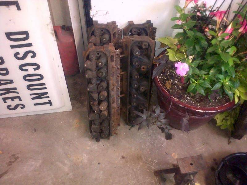

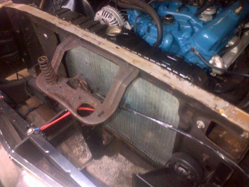

I got talking to a friend who advised me in the building of my 318, he said for a C body, the best head for torque is the 452, they come already with hardened valve seats, have a closed chamber and are better for low end torque. He figures there's a 99% chance that the '74 440 I'm buying was built with them.

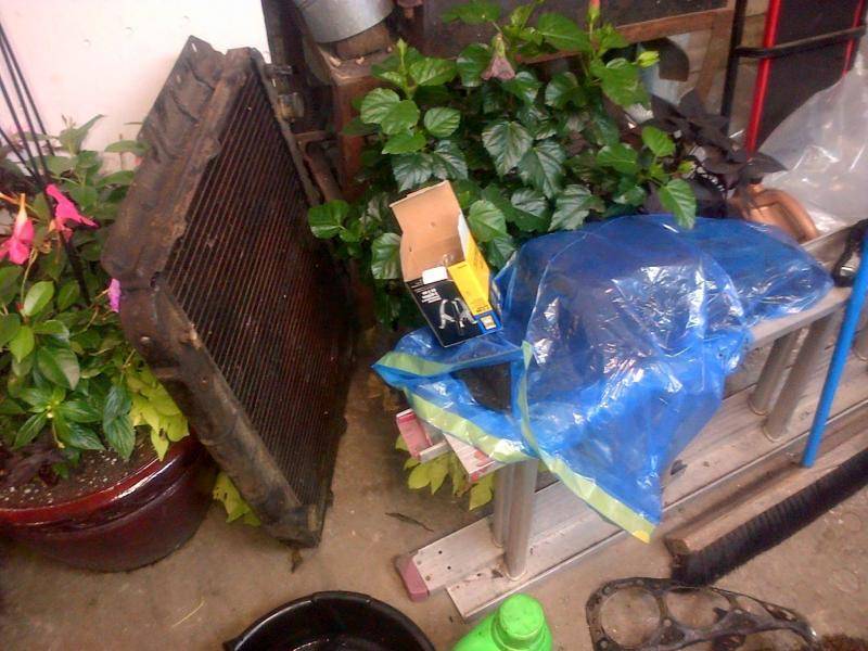

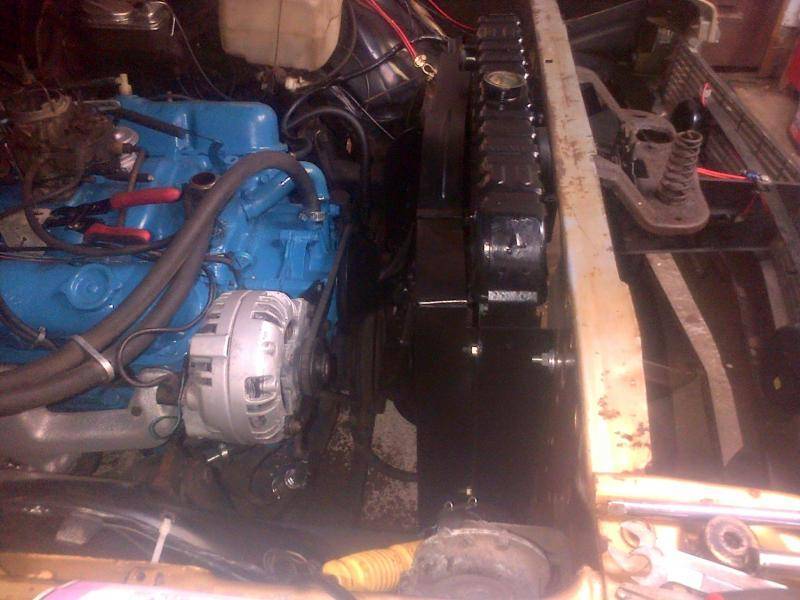

Anyway........Weekend didn't playout exactly as I planned, not that anything does lately........guy couldn't find some stuff, and my 440 seller and I's schedule's clashed. Oh well, he couldn't find the #302 heads or the carb, so he threw in another set of big block heads (#615) for free, $80 later I have a set of 452 heads, an oil pan and another 26" rad.
12034267_10207728671632210_7384212001652235972_o.jpg11249709_10207728671672211_5483643789669015172_o.jpg
452 are open chamber with hardened vavle seats and a 90-92 cc as cast on most the free set 615? 915 or 516 are both close chambers, both are good the 915 are better unported than the 516 but the chamber on both is the best.
The second set is a set of 516 heads. He told me 615, after reading your comment I went out to the garage and looked.
