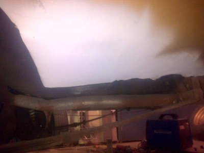

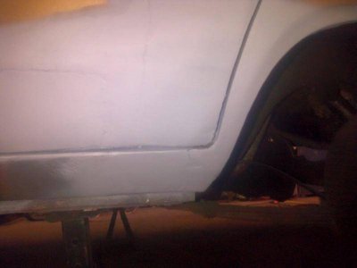

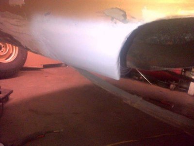

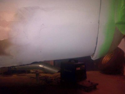

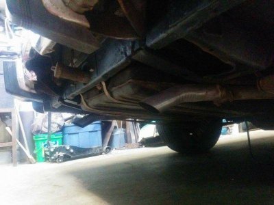

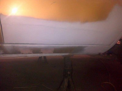

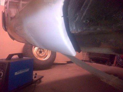

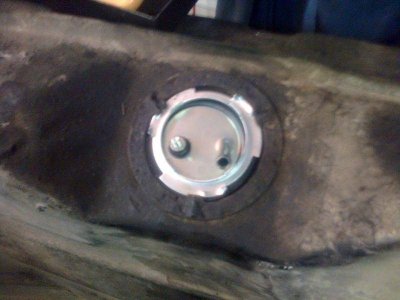

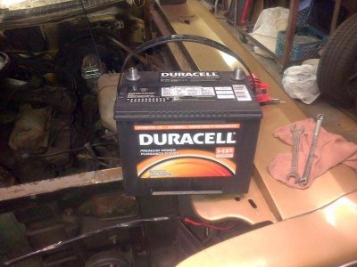

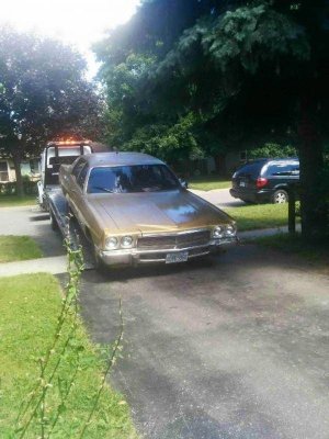

Anyway, saturday I'm going to get the car safetied and plated, o this week we are finishing it up good enough.
11816999_10207150982790350_3654387956447519425_n.jpg11037342_10207150991470567_4774491662978450561_n.jpg11825703_10207155762429838_8005097158409891404_n.jpg11811512_10207157986685443_341520692994416200_n.jpg11813357_10207157986725444_7024868758058127660_n.jpg11825732_10207157986765445_2669727036467254507_n.jpg11721906_10155925432770650_1024022602_n.jpg
Looking good Nick, you have been very hard at work. Glad to see everything coming together for you on Dennis.

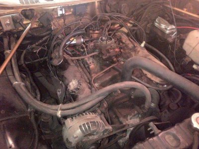

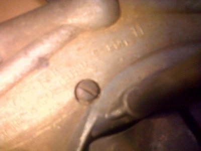

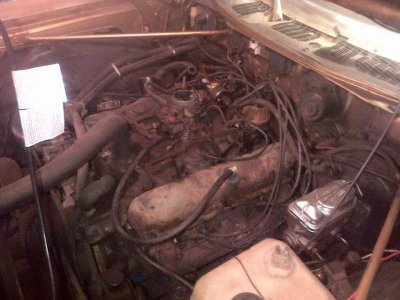

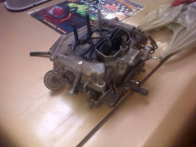

I hope you aren't going to try and rebuild the old thermoquad, they work good from new but age and heat warps the phenolic body, it can be a bugger to get running right. It really is a better investment to go carter/edelbrock or new.
What's the number on the driver side rear corner Nick. I see it is a 75 up year. Which means lean burn if it has 1 1/2" primary plates/bigblock, get your wire drill bits out.
