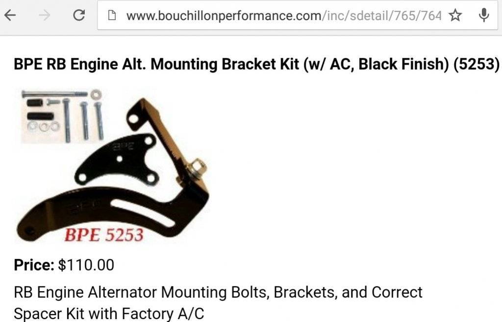

No I was talking about Stan switching to the lower style brackets like yours and my Challenger, that he needs to convert to Sanden A/C comp. I really think that he could just use the Buchillion kit but have to get a set of belts by measuring instead of by vehicle. Agreed on decent rebuilds I think some of the rotors out there have been soldered too many times.

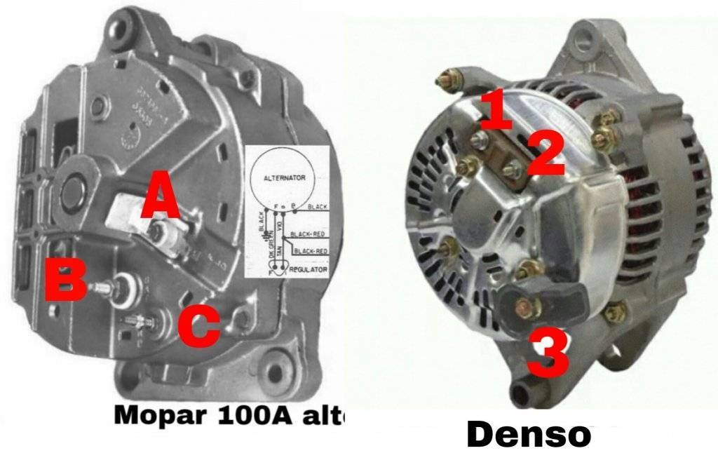

That says all the Denso alternators have an internal regulator. I'm confused now... Here's a pic from the other thread that shows field wire connections.
picsart_03-28-08-37-46-jpg.74657
I don't believe that is true. Denso is in the alt business not the car manufacturing biz so I believe they have a set up to go both ways.

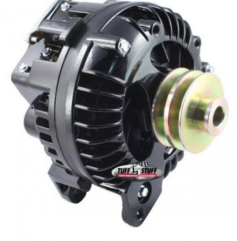

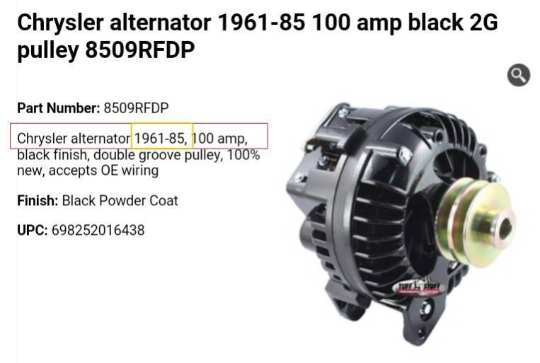

That Tuff Stuff unit is nice, but we all aren't Daddy Warbucks.:poke:
