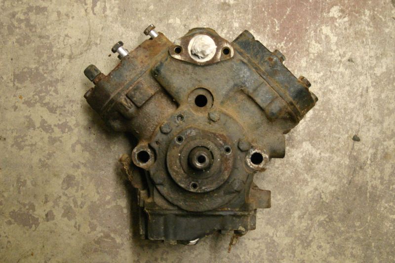

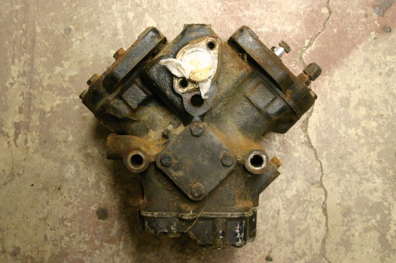

what the heck since dan commented on a 10 yr old post...the smaller V2 would usually be on an A body and wouldn't come with an EPR valve...the stroke is different between V2 and RV2...the RV2 crankshaft has extra counterweights held on to the crank with 3 countersunk phillips screws...the RV2 pistons have notches in them to clear the reed valves, V2 has flattop pistons...the V2 has a smaller front bearing (national 205)RV2 uses 2019681...the front bearing retainer is different as it is sized for the smaller diameter bearing...I THINK the basic block, valve plates and heads can be interchanged between them...one of the compressors i pulled apart had RV2 stamped on it but it was the smaller unit ...could have been done by a rebuilder mixing crap together...the oil sump pans interchange so after over 50 yrs its anybodys guess what could be slapped together...maybe the later pickups used the smaller compressor as well considering how small the cab is?
