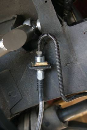

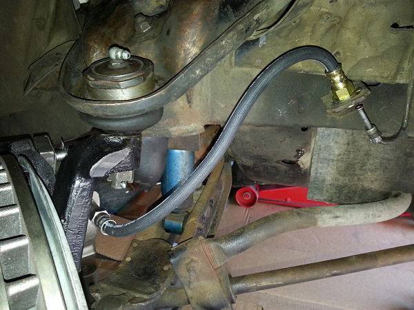

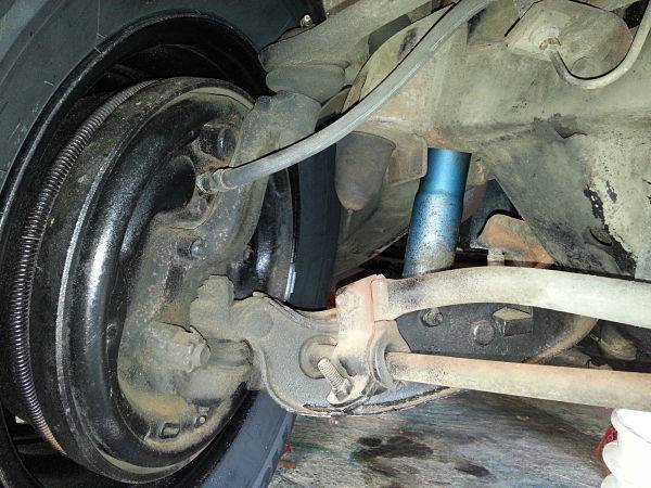

That said, can any C-Body '65-'66 NY, NP, TC guys who have done the disc brake upgrade chime in on what you did. Better yet, photos speak a thousand words so those would be appreciated. If you'd rather email me the info than post here that would be great too!

i dunno if your suspension travel is maxxed out during this picture you took - but think - for your car to stretch that brake line that far, your wheel has to be off the ground. if your wheel is off the ground when you are driving, you probably have bigger issues to think about.

Thanks Saylor :sSig_thanks: your $.02 makes all the sense! When I took the picx I didn't think about the front wheels hanging thereby maxing out the suspension and brake hose travel :eek:ops:
Feeling so stupid LOL!
Looks like the RAYBESTOS BH36845 with the banjo type fitting would work better than the straight line I presently have.
