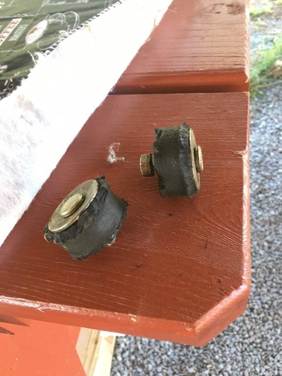

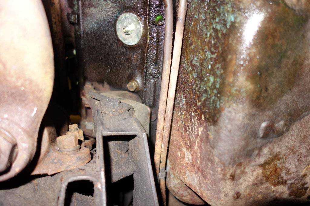

I have an overheating issue on a 68 Newport.
I've done lots.. burped, flushed, tested for hydrocarbons (negative) new shroud, radiator, water pump, fuel pump, checked timing, etc.
My latest trick was to finally replace/yank the 2 "temporary plugs", 1 from each side, thinking this might inhibit flow.
[ FYI - this stank since they were deformed/mushroomed a bit, and I had to push them into the block and trim off (circumcise) the inside ring in order to get them out.
I'm curious if losing the plugs (that I think were there as part of the lost sand process, and maybe not for preventing block frozen crack-age, but I don't know), means that the block is damaged.... trying to figure this out..

Now is a good time to get in the block with a hose and flush out each side. Sometimes I have seen the passage close up with sediment. This is something you can see with the plug out.

I used the same temp plugs. Used them to replace leaking factory freeze plugs. Bought the temps at Advance. Never completely sealed. Had the same trouble getting them out of my 318.
Proper sanding to clean mounting surface, metal freeze plugs, Permatex 2 Form-A-Gasket Sealant, and a good mounting tool sealed the deal for me. No more antifreeze leaks.

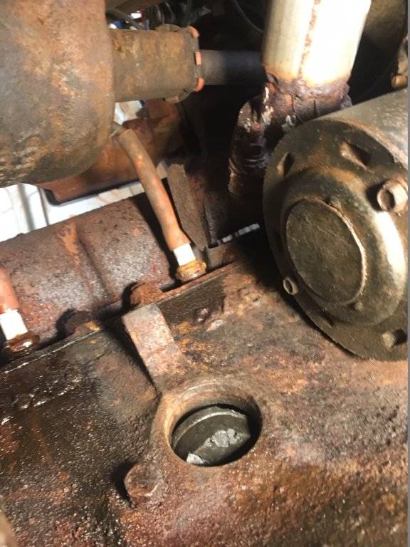

Thanks! I have a cheapie yet goodie endoscopic camera. I'll fish around in there looking for some crud. Is there a particular location to look for build up? I heard someone recently mention to yank the intake and look at the coolant passages. I suppose after a good flushing and if the over-heating still persists, I'll try that.
There is also a drain plug on each side of the block. I've never removed these before, but will attempt this as well.
Those drain plugs have probably been in there for over 45 years, not going to come out easily. With the freeze plugs out you do not need to remove them anyway, (and you don't want to break one off in the block).
Remove the block drain plugs, since the holes are usually crud'ed up and need a screwdriver to get them to flow. There is often stuff left over from original manufacture, like steel wires, inside. Best to reseal those "core holes", even temp, and run the engine for a few hours w/ pure water plus ~1 lb citric acid, then flush well. I bought 5 lb citric on ebay. The latest Prestone flushes seem wimpier. I run Evans Waterless Coolant in all my cars now (1964 thru 2002), some for several years w/ no overheating issues. Neatest thing is you can open the radiator cap when hot and no appreciable pressure build-up.
