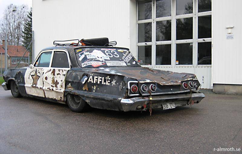

Neutralize the rust, drive and enjoy. This isn't always my advice but for this car that's what I suggest.
Agree, this is much better than using fiberglass or something else just to hide it..
Not even this car would do better with fiberglass :icon_lol:
