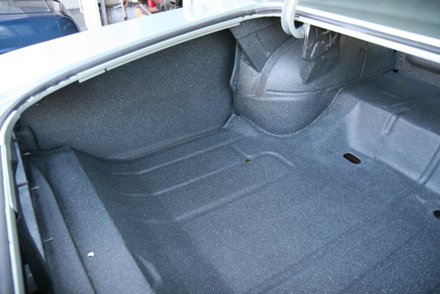

Here it is this next morning. The epoxy is still semi-soft as expected.
While I wait a few more days, here's where it gets interesting. Some more research turned up talk about using this with excellent results on metal pans, regardless what the label application says. This will be the "encapuslator"
$25.00.
I did a small "test" patch while the epoxy sets. 1 gallon covers 25 sq ft with two coats.
