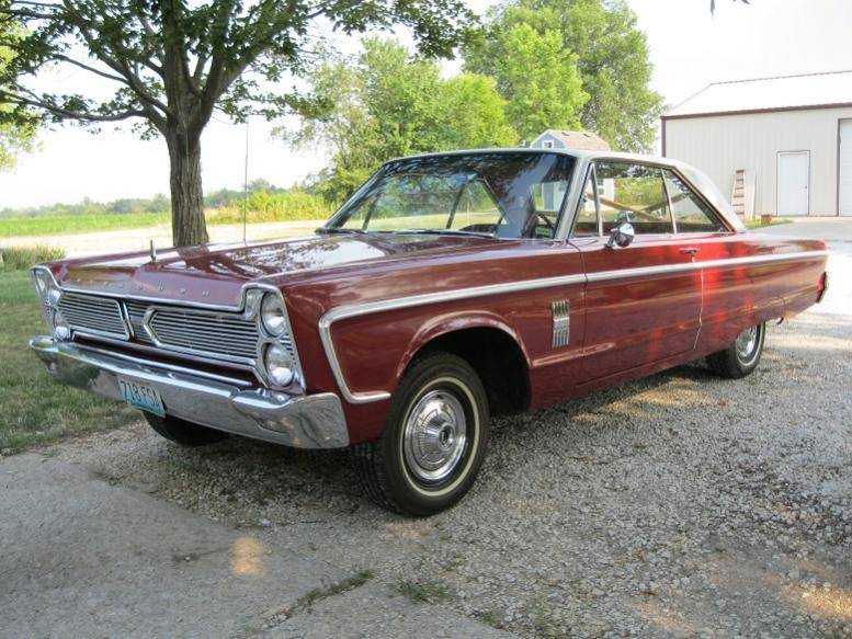

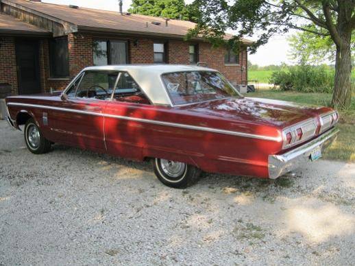

I've pretty much decided to keep my 66 Fury III that was my dad's and do the 440 swap that he was collecting parts to do. What I'm asking from you guys (and gals) is to help me with info on the differences underhood in my 318 poly car and a factory 440 Fury. If you have a 66 Fury with a 440 and its either a factory 440 car and still correct appearing, or if you have done what I'm gonna do and did a swap to look factory, I'd REALLY appreciate underhood pix, LOTS of pix. Lol. I'd like to see some good close up pix of the throttle and kickdown linkages, bellcrank etc. Also correct valve covers and intake. This is a non-A/C car that will be getting aftermarket A/C at some point. This will just be a lot easier than swapping the dash and heater box and cutting more holes etc. Anything you can help me with in the way of the differences would be appreciated.

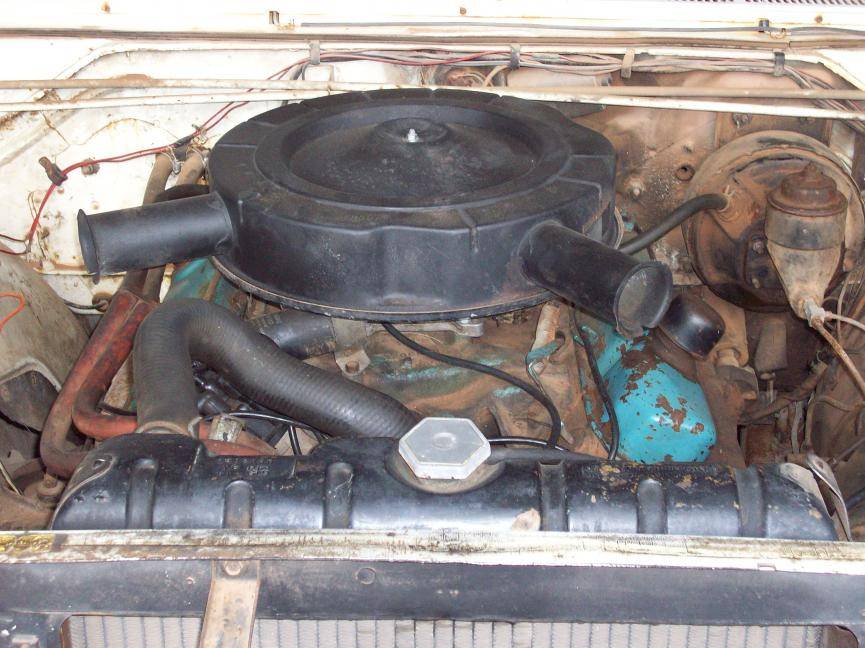

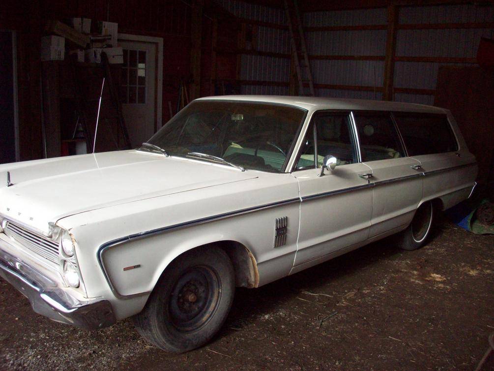

hope these pictures come out. they are from my 66 fury 440 4 speed numbers matching wagon. 100_0415.jpg100_0420.jpg
That car is amazing, I think we'd all like to see more of it. Click the box that says "Forum" in it at the top of this page, then scroll down through the list to the forum titled "Members projects and restorations" and click on that. Once on that page you will see a box that says "start new thread" just above the list of threads, click that and you'll get it from there.
thanks detmatt i will do that and post some pics of the progress on this badboy.
Did you buy this car off E-bay? A big block 4 speed wagon how rare is that.
