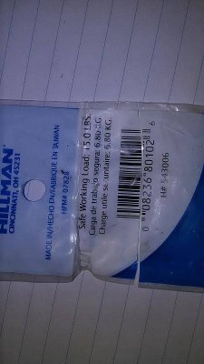

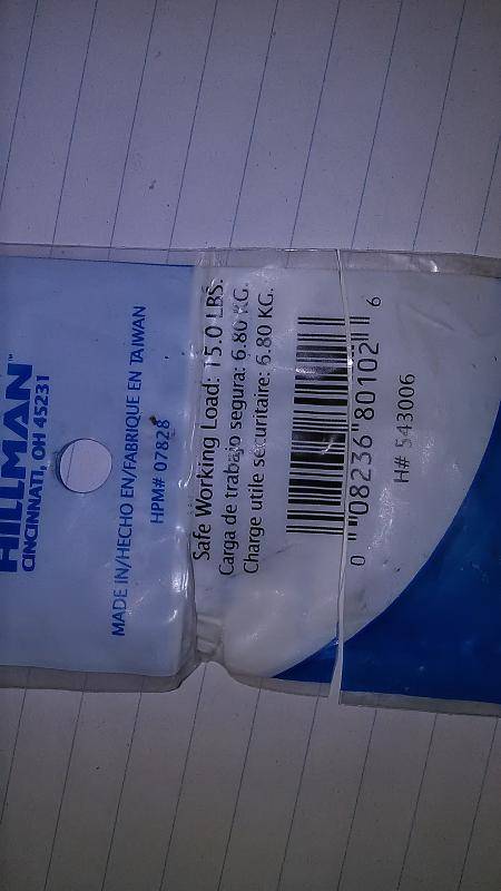

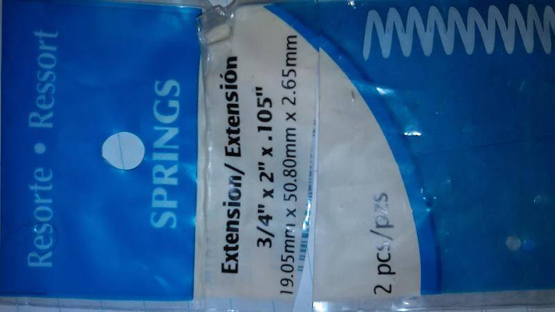

Hello in C-BODY Land! I posted an earlier need for Door Hinge Springs for a 1968 Polara, but my cries from the C-Body waste land when unanswered, except for one brave soul. So here is what I have found, that seems to be a perfect replacement Spring at your local Lowe's Hardware Store. Hillman Extension Spring Part HPM #-07828 3/4" X 2" X .105. Works like a charm. Be sure to use the 15 LB one's!
It's great when someone takes the initiative. We all benefit.
One end has to be closed just a little. You insert that end into small hole. Then with a good pair of Needle Nosed Pliers, you lever the Spring over the dimple in the Arm.
Here's a shot of the package mine came in. IMG_20150607_223251.jpgIMG_20150607_223346.jpg
