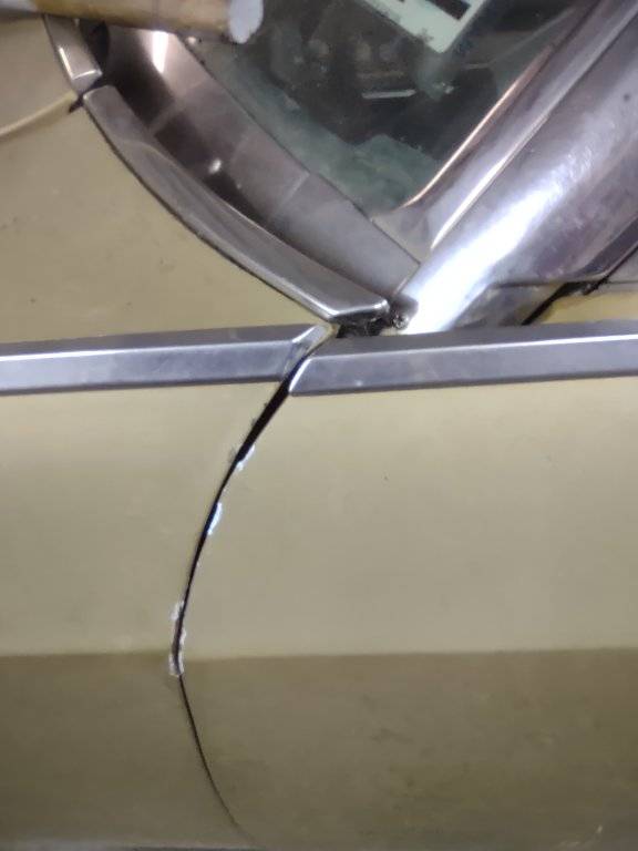

My drivers door sits lower than the trim chrome and body. Pass side does not. I loosened all hinge bolts on frame side, jacked up door, and the tightened bolts. Almost no change. I loosened all hinge bolts on door and did same thing. I may have raised the door 1/8 inch. Front to back spacing is good. Both front edge and rear edge of door are both law same distance. Still close to 1/4 inch low. Any thoughts? I didnt find anything bent or damaged.

Looks like the door is to far forward in the opening (the paint chips verify that). Gaps should be consistent front/back. When the door is opened, can you pick up the handle end? Does the feel loose/rock? If so, the hinge pins are probably the culprit. When the door closes it should strike the pin and raise up maybe a 1/16 inch. A service manual covers this procedure.

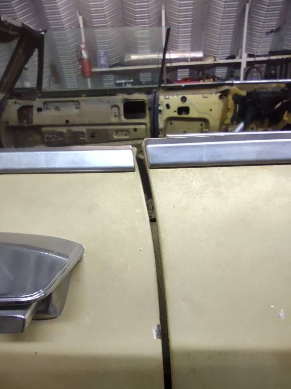

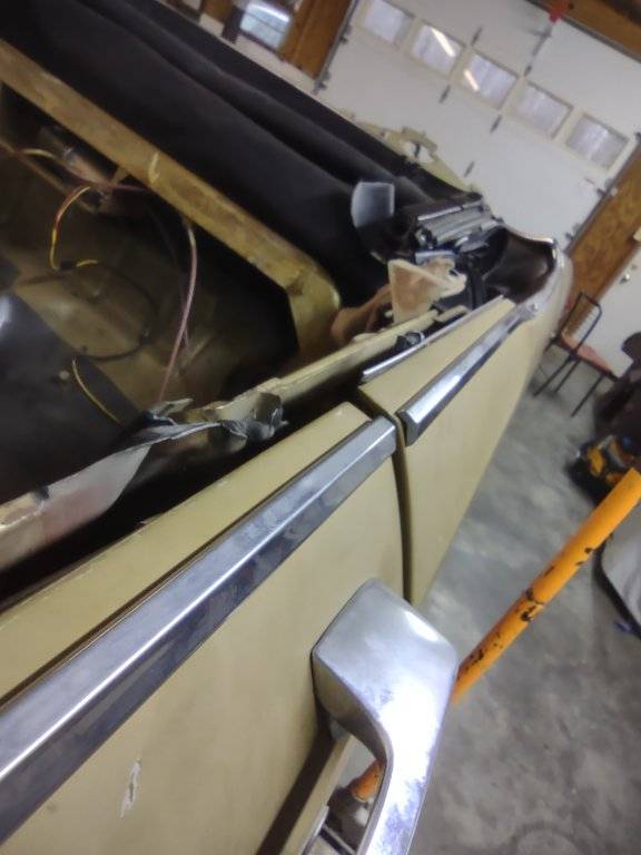

You have a narrow gap in the front and a wide gap in the rear. They are both pretty even from what I can tell in the pictures. Looks like it should just be a matter of proper adjustment. There's no secret to adjusting it, it's just trial and error. first you need to loosen the hinges on the body and move the door back and up. After you get that see what you have. the adjustments on the door are for in and out. And yes remove the striker so it isn't changing the position of the door.
I did loosen all the bolts and raised the door. It came up only about an 1/8 inch to what you see in the picture. I forgot to move it back some so ill try that tomorrow.

If I were faced with this issue, I would pull the fender to gain easy access to the hinges. Hinge to body and hinge to door. Get the door aligned first focusing on the door quarter and bottom gap, then work on the fender.
It appears the fender is too far back at the bottom but aligned close with the hood. Moving the bottom of the fender forward would improve your gap. Good luck.
