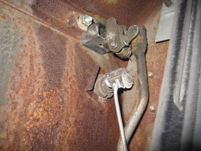

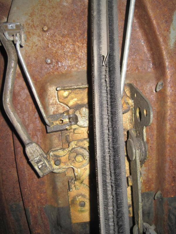

I really can't help you but I took some pictures of the lock mechanism and can see if at some point someone didn’t re-install them correctly or as you can see from the photo that the lock linkage can not be switched but maybe it is some how twisted around the door button linkage.
View attachment 9100View attachment 9099

I take tons of pictures when ever I take something apart. I am luck to have a virtually unmolested car everthing is there just some things need replaced.
I know this vendor will ship overseas. http://www.cbodies.com/carsparts2.htm I am sure he has what you need.
I would send him an e-mail, if you don't get a responds drop him another line. Feel free to use the pictures I posted, in fact I would highly recommend the pictures to avoid confusion. If you have any problems reaching him send me a PM and I help out in contacting him. He may not want to open a file from overseas. Feel free to use my name too, which might get you a quicker response, my name is Mike Madden.
