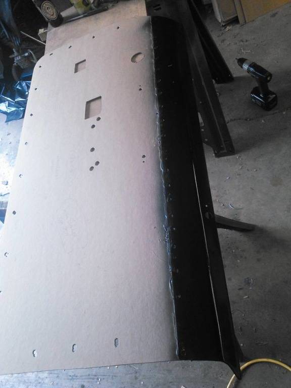

I used this:
http://www.perfectfit.com/15347/154532/Chipboard-Car-Panelboard/Kraft-Tan-Waterproof-Panelboard.html
It's very similar to the original, but I think it's more resistant to water. The nice thing about this is you can trim it easily with a utility knife. I also used some leather punches to make the holes.
The tops are the original sheet metal. They are glued to the new boards.

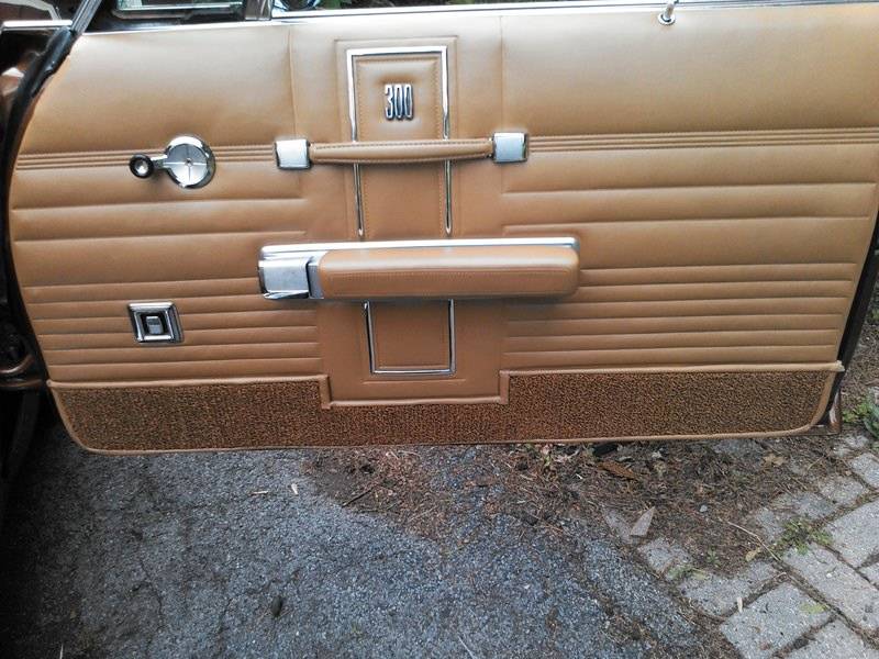

My fix turned out pretty good and unless you had another 300 door panel next to it, I doubt if you could spot the difference.

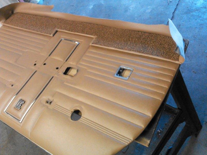

The door panels in my 300 looked pretty sad. Years of sun and no plastic sheet behind them took their toll. They had been green sometime in their life too and the brown dye was wearing thin.
One of the rear panels had this fix.

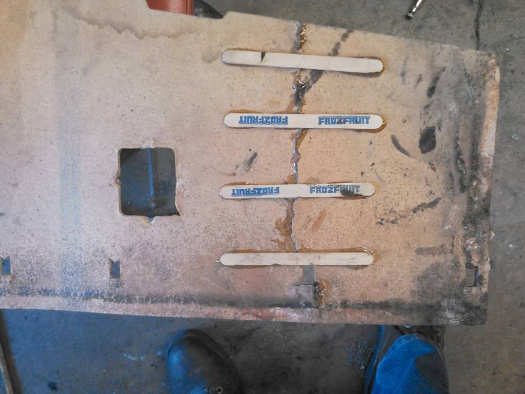

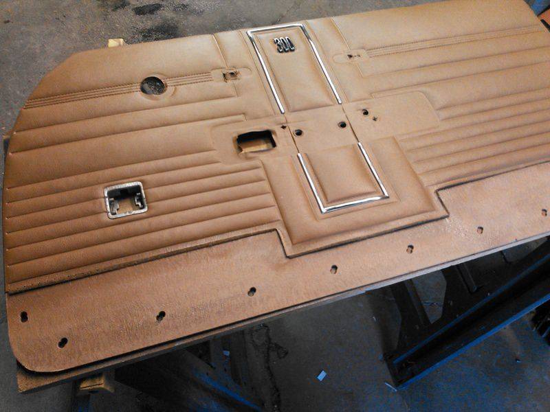

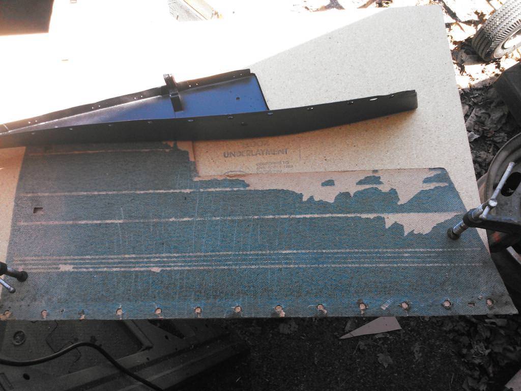

I stripped the panels of their upholstery and made some new panels using the old as a pattern.

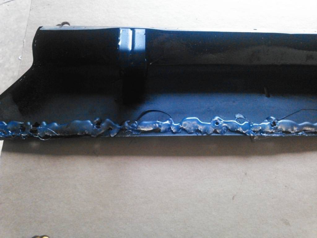

The steel top of the panel presented a challenge. It was originally staked to the board around a series of holes. I couldn't get that to work so I spread hot melt glue on the steel top. I couldn't work fast enough to get them to stick together so I clamped everything and hit it with the heat gun to remelt the glue.
I used 3M Trim adhesive to glue the vinyl to the new boards.
The color turned out to be a bit of a problem. I couldn't get a color that was close and custom matching and mixing was one answer. The issue was there was no original color for a good sample. Much of the interior had been replaced with green panels that had been painted brown. After a lot of thought and some false starts, I decided to change the color slightly and use off the shelf SEM color coat in a camel color.

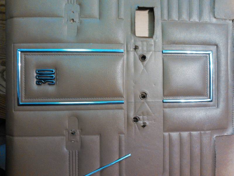

The chrome trim on the front doors was in rough shape too.
I tried to figure out a solution and while I was fixing the chrome trim on the headrests, I discovered the trim would work on the door panels too! It's a little wider, but it actually fits better in the groove than the original stuff. I bought this at Auto Zone
All that's left is to finish the carpet insert on the bottom (Mrs Big John will be stitching that for me) and they will be back on the car.
The bottom has a strip of carpet across it. This turned out to be a big challenge.
I cut a piece of chip board and glued the carpet to it using 3M trim adhesive. Then Mrs. Big John stitched some vinyl around the outside.
Glued the chip board to the panel
Stretched and glued the vinyl, using 3M Trim Adhesive, around the edge and added clips.

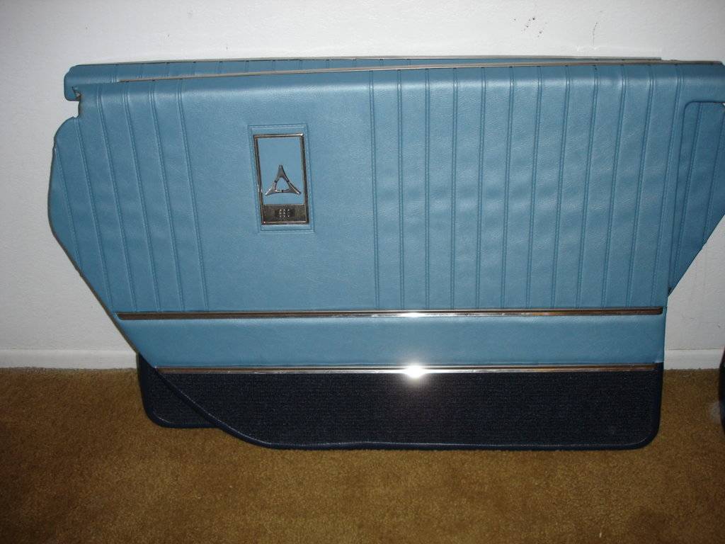

Finished panel. The corners of the vinyl aren't the greatest (I did those) but they look better than the pro that did it before.

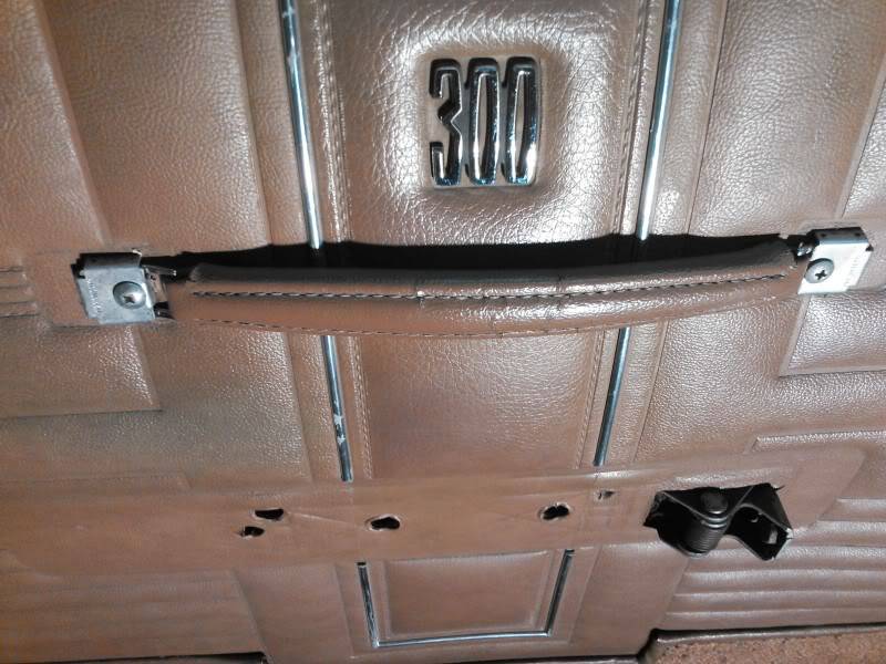

Very nice, creative work on the panels. Came out great. What I was wondering is how you fixed the door pull straps. In the "before" photos of the panel, those pull straps had some cracks in them. But the "after" photos showing the finished panel seem to show door pulls without the cracks anymore. What can you tell us about those repairs?
