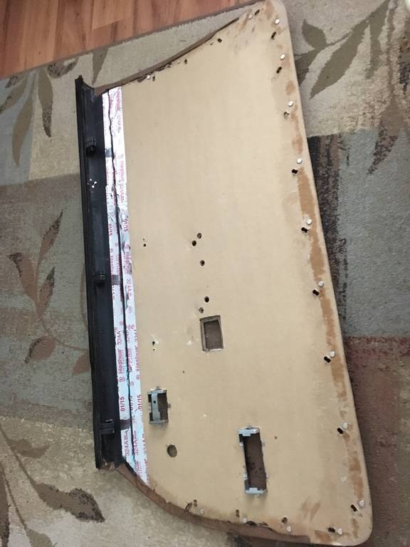

So... The last time off, finally, the hot melt glue broke on the top where the board fastens. Not a big deal, but I took it off and repaired it today. I reheated it with my hot air gun and melted the glue and viola, it's all stuck together again. I also ran some aluminum tape across the seam.
Then I did something else I've wanted to try... The clips are always a PITA. I took all them off and super glued some thin magnets around the edge. A couple test fits had me add more magnets (25 total). A little more fitting and I decided to use three clips. One at each lower corner and one in the center along the bottom.
This worked really well. The panel went on really easy and stays close to the door nicely.

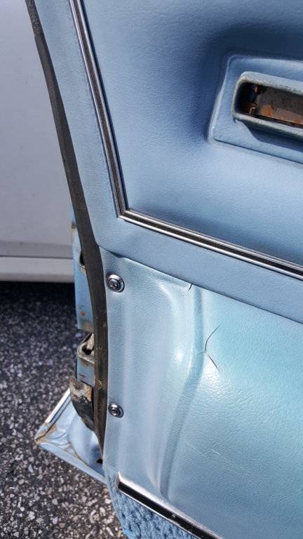

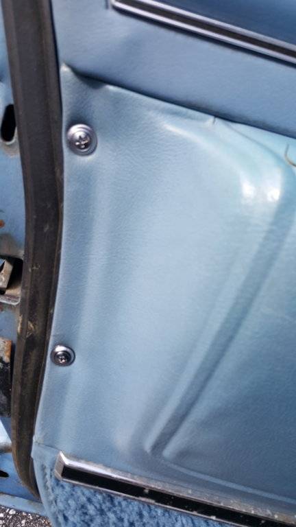

I never liked how the carpet around the bottom came out. It was OK, and for my first foray with the HD sewing machine, it was actually good, but still, I wasn't happy. I cut a new piece of carpet and ran some vinyl edge trim along the top, then glued it to the panel, trimmed it up and put more edging around the carpet and the panel. This takes the notch out of the carpet, so it's not quite like the OE, but it's cleaner and I think it's much better than my original try. I also touched up the paint while it was off.

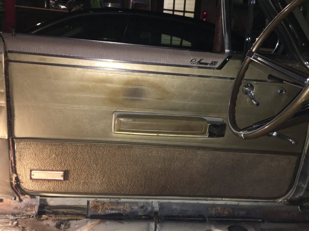

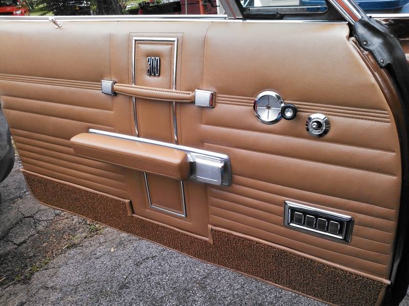

Before:
After:

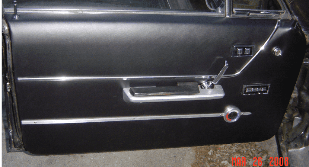

Here's what I did 10+ years ago for my 300L.
Used a good donor board from another car, covered with fleece and vinyl from the fabric store, vinyl glued/stapled around the edges, with some stitches around the backside corners. Upper trim is from 66 Newport, made lower trim from aluminum, the emblem is a round puck from Mcmaster that got machined a little. Emblem inside was a graphic my wife made based on a photo-scan of an original, printed it out, cut to a circle, placed in the recess of the pocket and covered with clear table-top epoxy resin. If I had to do it again I'd reconsider - I spent at least 30 hours on all of it for all 4 -- and although it made a huge improvement I think now I'd just buy a nicer car and go driving instead! Had to stitch that funny area up by the vent window also - major PITA of the 65-66 Chrysler door. Fortunately visible only when the door is open.

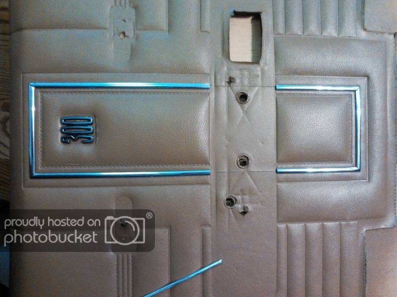

The color turned out to be a bit of a problem. I couldn't get a color that was close and custom matching and mixing was one answer. The issue was there was no original color for a good sample. Much of the interior had been replaced with green panels that had been painted brown. After a lot of thought and some false starts, I decided to change the color slightly and use off the shelf SEM color coat in a camel color.

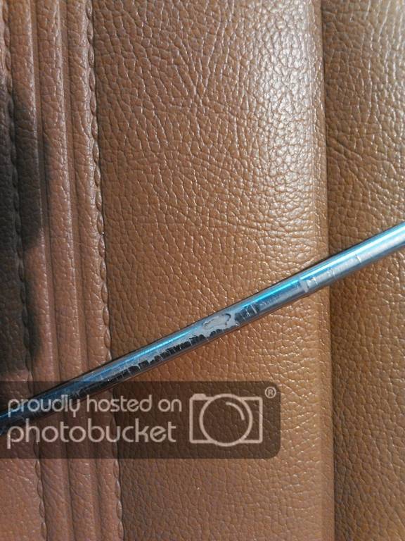

The chrome trim on the front doors was in rough shape too.
I tried to figure out a solution and while I was fixing the chrome trim on the headrests, I discovered the trim would work on the door panels too! It's a little wider, but it actually fits better in the groove than the original stuff.
All that's left is to finish the carpet insert on the bottom (Mrs Big John will be stitching that for me) and they will be back on the car.

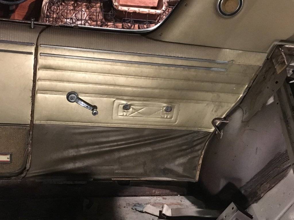

The '65 300L door panels needed some love, and I tackled this again. This time, I tried to use what I learned from the last time, along with some suggestions I've read from others.
The board on both front and rear panels had gotten wet over the years, not surprising with the plastic missing. Most of the clips had already been torn out and the boards were wavy. Not what I wanted to do, but it needed to be done.
