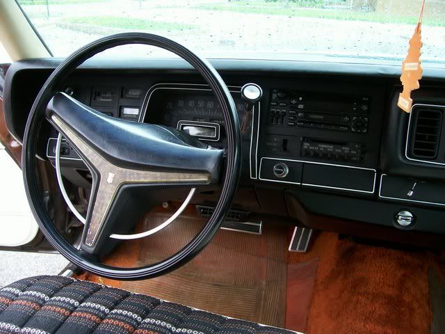

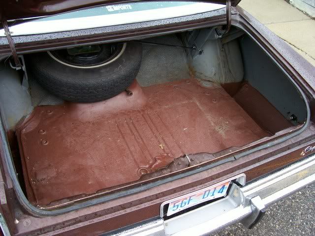

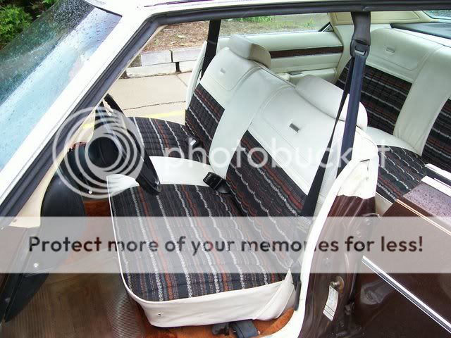

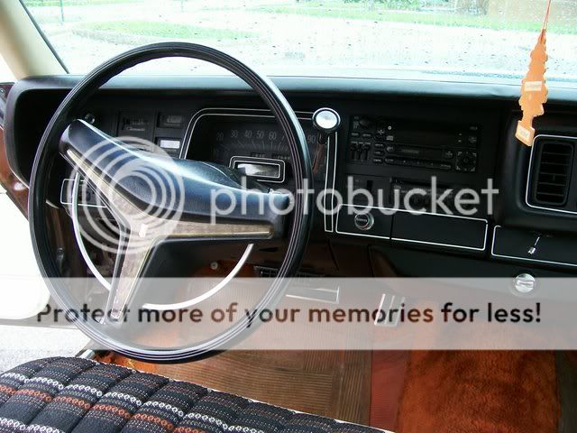

But my last winter C was this '74 Newport that was on eBay circa 2007 and only being bid by people name "DeRbYhOliC" or "Capt'n Crash". I figured no matter what happened to it with me, it would be far better off. So I bid, drove down to TN with a friend and came back. I think I was into it for less than $2000. Of course these pics are AFTER I put a buffing wheel to the paint and swapped the OE road wheels with some junky Cragers (I kept the road wheels when I sold it).
Can you believe I got this much cool for under $2k?

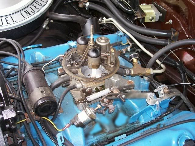

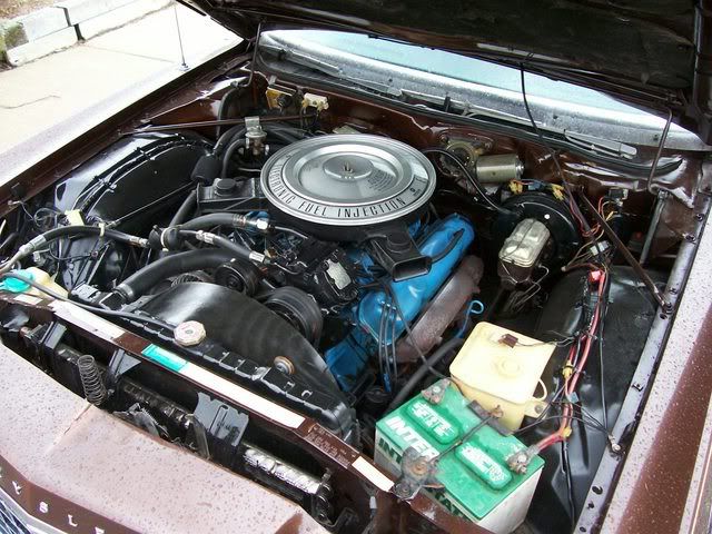

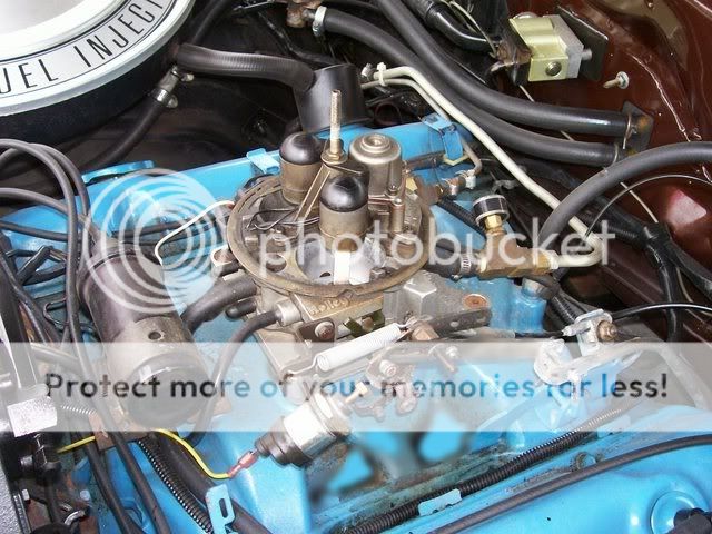

Now I also thought "Maybe I should throw on a TBI system" So I scored a used Holley Pro-Junktion system on eBay for maybe $200. Having used one of these in the past, I didn't have high expectations. Here's my install:
Hey, looks like the factory did it huh? Thank you junkyard '81 Imperial.

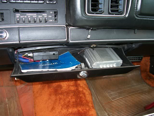

I mounted the controller in the designed-with-airbags-in-mind center-mount glove box.
That little box mounted on the left? Remote starter. Why not take advantage of the TBI, right?
Oh yeah, I upgraded the tunes quite a bit as well.
So having said all that, and being all-in on TBI, would I do it again? Meh, probably not.
The power and fuel economy were really no better than a carb. Fuel injection (and in my opinion even electronic ignition) really just mask out-of-tune parts... My cold weather starts were good, but I have well-tuned carb vehicles that run just as well. In fact, I keep my '73 Dodge truck 400/727 (E-brok 4bbl) around year round, outdoors and count on it to start at all times. You know the best cold start upgrade? Big-*** battery and the faster starter from a 90s V8 Mopar. (I do hate how it sounds. I wish I could make an external speaker play an Mpg of a old starter when I hit the key.) The remote start was kinda fun to spook people in parking lots, but the aftermarket kit's range was so crappy that by the time I got in, it had only been running 15 seconds. :rolleyes:
