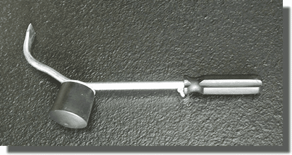

You have to get under the lip. I would start with a plastic trim tool to start, and finish with a bent tip pry bar or a wheel cover tool specific for that job.

Start with a small flat screwdriver to get the wheel cover off far enough to put a larger screwdriver or pry bar under the edge.

If you do need to change them, this is how I did it. Post #13, 14 and 15 in this thread. Tool tips You could also use a large hammer to knock the stud out, but you need to be careful. While I've changed them with a couple greased washers and an upside down lug nut, the tool I show makes it a little easier.

Thanks for the tip on the covers. That was kind of my thought process, but it seemed so tedious that I didn't think Chrysler would make us go through that ^_^. I guess daily users would just have to live with dented cover edges if they got a flat on the side of the road and had to use the crowbar!
My 1960 Dart has the full wheel covers that cover the rim also. I use a flat screw driver to pry the caps off and use a rubber mallet to tap them back on so as not to dent them up. Your car has all right hand lug nuts as was reported earlier. Your old lug nuts should all be reusable and fit your new rotors.
