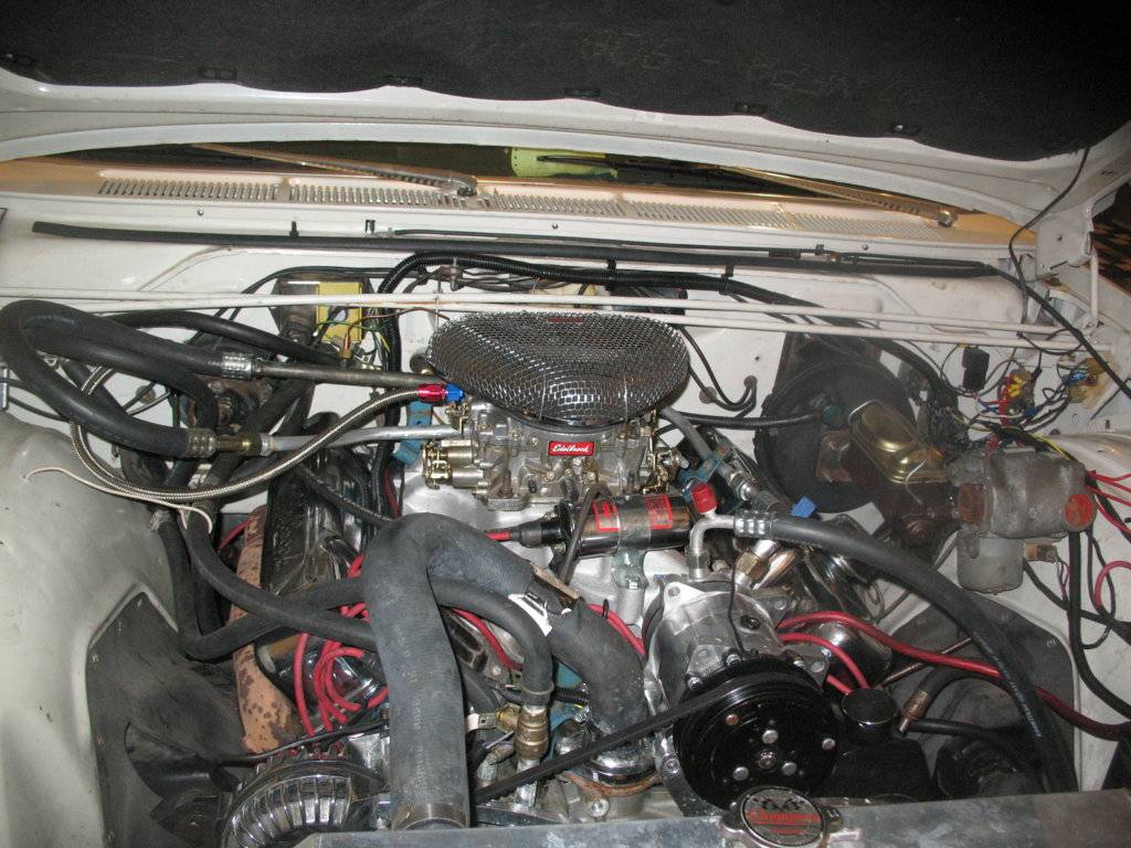

My 66 new yorker 2dr has an Edelbrock Performer RPm and a Performer 1407 carb. Don't use the original air cleaner so I can't answer to it's fitment. But the hood closes with no issues. Here's a photo of what it looks like. I switched to a sanden compressor a while back so I don't have any issues with compressor mounting. I am working on changing to an Fitech 30002 EFI this spring.

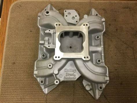

Reviving this thread. I’m now also considering a Holley street dominator also. Anyone have one and know the carb height compared to stock manifold?

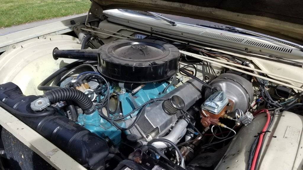

I want to be able to use under a stock 70 air Grabber hood so should be pretty close to stock height as I’ll be using stock air cleaner, if I can find a 440 4 BBL base. If you have a 440 cleaner please PM me.
What’s all that in the rear center for?
