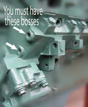

I believe to put the 440 in the 65 you need a swap mount for the drivers side

Where would I get the mount I need? I'm not even sure what I should search for...

But if you don't have those bosses, Schumacher Creative Services makes a conversion mount that requires drilling and tapping into the oil pump bosses, not that hard to do.
I stole this pic from another thread a member was doing the swap. I modified my original bracket, it was not a hard job.
I posted a pic here but couldn't find it, got the lazies.
Schumacher Creative Services should be able to help you. engine-swaps.com is the site.

Schumacher DOES have a conversion mount if I need it. It's not on their website, but I called them and they confirmed that they do have a kit for putting a non-boss motor into my C body.
